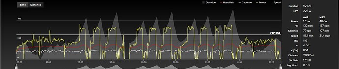

Hah! That’s basically what I did (only 3 sets though). Equal recovery between efforts and 5 mins between sets, although not necessary. I’ll have to explore the catalog more and find these options. I just hit the lap button early and went from there.
