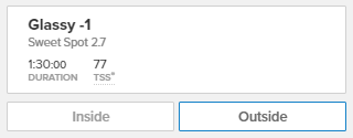

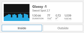

Question regarding workout levels for indoor vs outdoor rides.
For example:
vs
Same workout but different levels when done either inside or outside.
It’s the same for some other workouts but not all:
vs
So my question is. Is this a mistake? Or if it’s not then if I had San Cristobal scheduled but I want to do it outside, should I then find a similar alternative from the workout library that has workout level 4.0?
@IvyAudrain any insight?
Outdoor rides often have different interval length/intensity changes from Indoor to make them easier to execute. I’m picking that’s why they are different, though I haven’t looked at those two, the Outdoor is probably “easier”.
I reported a similar issue to TR support and they acknowledged it was a mistake and fixed immediately. I’d shoot them an email
