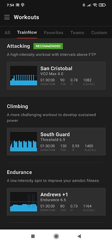

My first non-endurance “Recommended” Workout :grin:.
The system seems to work :stuck_out_tongue_winking_eye:. This is the last day of my rest week between SSBMV2 and SusPBMV, though I did catch up on Lecomte on Friday, AT clearly thinks I’m ready to go again.

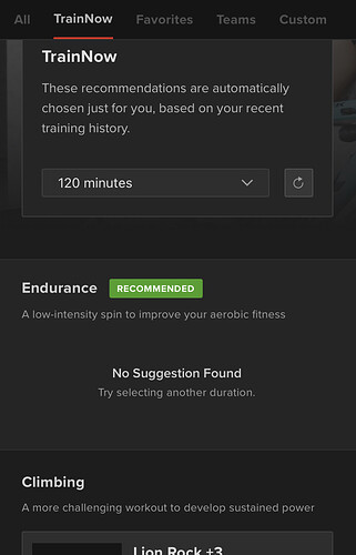

Tuesday morning and last ride was 3 full days ago on Friday. That was a 2-hour ride with 1x60-min at 88% FTP. Most of my rides are 2+ hours.
Finally a non-endurance suggestion from TrainNow. This is only the second time I’ve noticed a Climbing/Attacking recommendation, however I haven’t been looking everyday.
60-min
  • Levels look really low
  • something doesn’t seem right with TrainNow when doing outside structured workouts on a Garmin
  • workouts are sync’d from TrainingPeaks to TrainerRoad.
75-min
  • missing an Attacking workout suggestion.
90-min:
105-min:
  • Missing suggestions for Climbing and Attacking workout suggestions.
120-min which is my typical target when riding outside:
  • Missing Attacking and Endurance workout suggestions.
