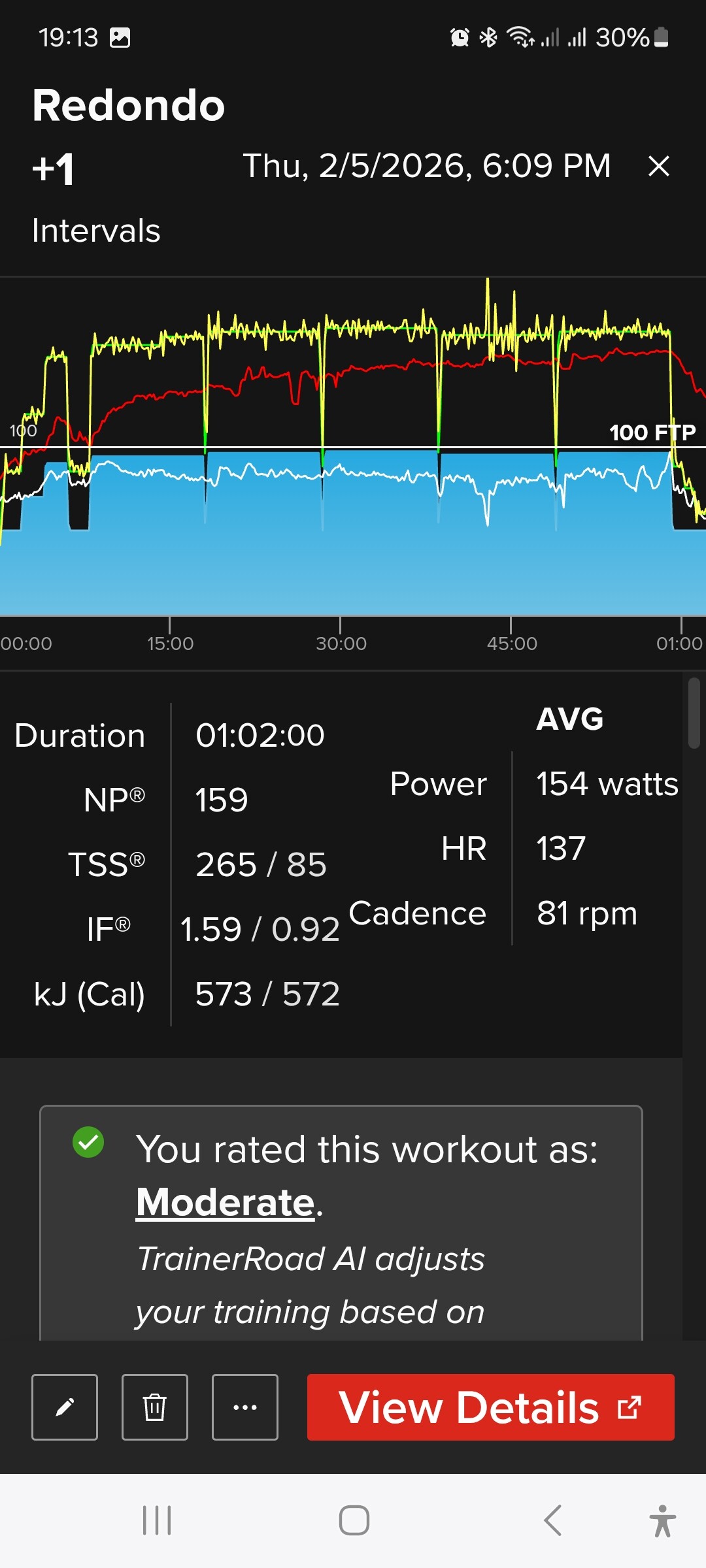

Just to add some detail and I think confidence in TR AI. I’m an ex-300FTP person on TR 20min tests of the past. I had worked up to a 250FTP in early Jan this year but was reduced to 235FTP with the new AI upgrade. I was a bit unhappy obviously but read the TR comments about this and accepted the new reading. What I can say is that yes, I’ve completed all my Hard interval sessions but they were ‘Hard‘ and some just do-able. So I think TR have got it spot on and I have a predicted 241FTP in a few weeks. Yes, I’ve a 300FTP goal but the fact that I’m close to my training limit but still able to progress is goal really and that 300 figure will come and or I’m getting fitter.
I have a very si.ilar problem and it is not “solved” as noted above, wasting a months training because AI can’t generate correct workouts is a fundamental issue caused by awful software design.
My AI determined FTP is around half the correct value. The app won’t create workouts based on a manual FTP input. The rides I’m offered are totally useless. I could easily have done the so called “Sweet Spot" workout -supposedly just beliw FTP - without breaking into a sweat. I had to manually increase the effort by 175% to get a workout but after completion it nothing changed. It was totally ignored by AI. Why should we pay for this - I don’t want to spend a month training with the wrong workouts.
Most riders will end up with a wrong FTP at some stage e.g. not completing a ramp test due to some issue, illness or injury. Please don’t tell me to do another ramp test, I’m fed up with being given excuses or suggested workarounds. Please get your software team to actually FIX THIS FUNDAMENTAL FLAW. It’s not acceptable to waste a month’s training just to allow AI to catch up.
FTP set at 100 by AI. Average actual power 154 watts for an hour and it was still not sufficiently difficult. These are not workouts. It is total crappie.
