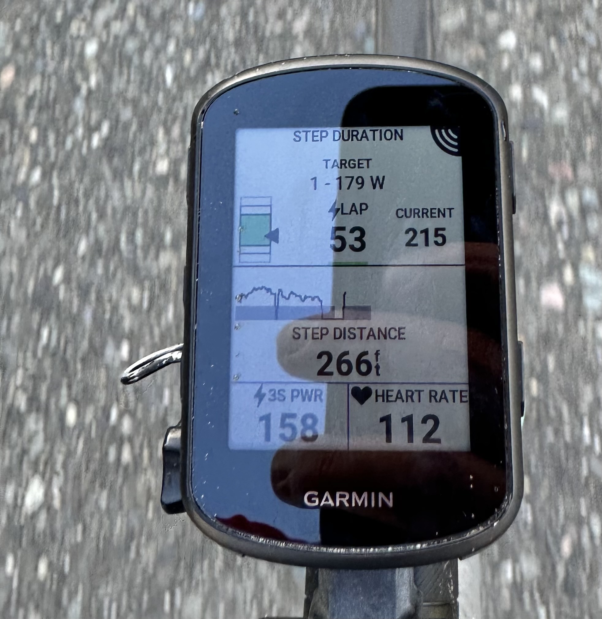

Adding to this (and I have not yet had time or bothered to dig into this), but I seem to have “ghost recovery” intervals when I do outdoor workouts on my 840. After a scheduled recovery interval, the “ghost” recovery interval occurs (goal wattage 0-124w) and there is no timer or countdown associated with it. I need to swipe up on the workout screen and then arrow over to the next work interval in order to advance, otherwise it will just sit in the “ghost” interval.
When I would do outdoor workouts on my Roam V1, the screen was simple and intuitive…the default Garmin workout screen is a hot mess.
Yes! Same! WTF is up with that? I was so confused I took a picture of the screen the first time this happened. It’s like a 90s “recovery” interval with no timer visible, appended to the real recovery interval (which happens normally.) In my case with was with Nunburnholme, a workout I’ve done many times outdoors with Wahoo and never experienced this. Anyone know the cause and a fix?
I think you are on a “end interval with lap button” interval, in this case there is no count down, but it still provides you with a target power until you press the lap button for the next interval
Can you elaborate on this? I am just pushing the TR workout to the Garmin and that interval does not exist in the workout.
TR added it.
Another TR created problem.
Also confused. It does this at the end of every rest interval, and these extra rest intervals don’t exist in the workout. If you do nothing you will progress to the next work interval after ~90s. This doesn’t happen with Wahoo head units as far as I can tell.
Is this supposed to happen, as a way to give you some “slack” in the rest interval? I have not tried hitting “lap” to proceed to the next interval; if that actually works this is a somewhat handy (if rather opaque) feature.
