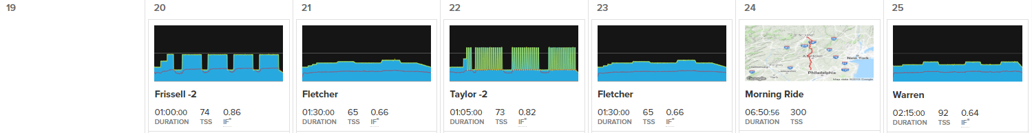

My baseline cardiac drift is pretty good (this is from Warren this past Sunday) so I’m not expecting significant gains there - just looking to try something different for a few months

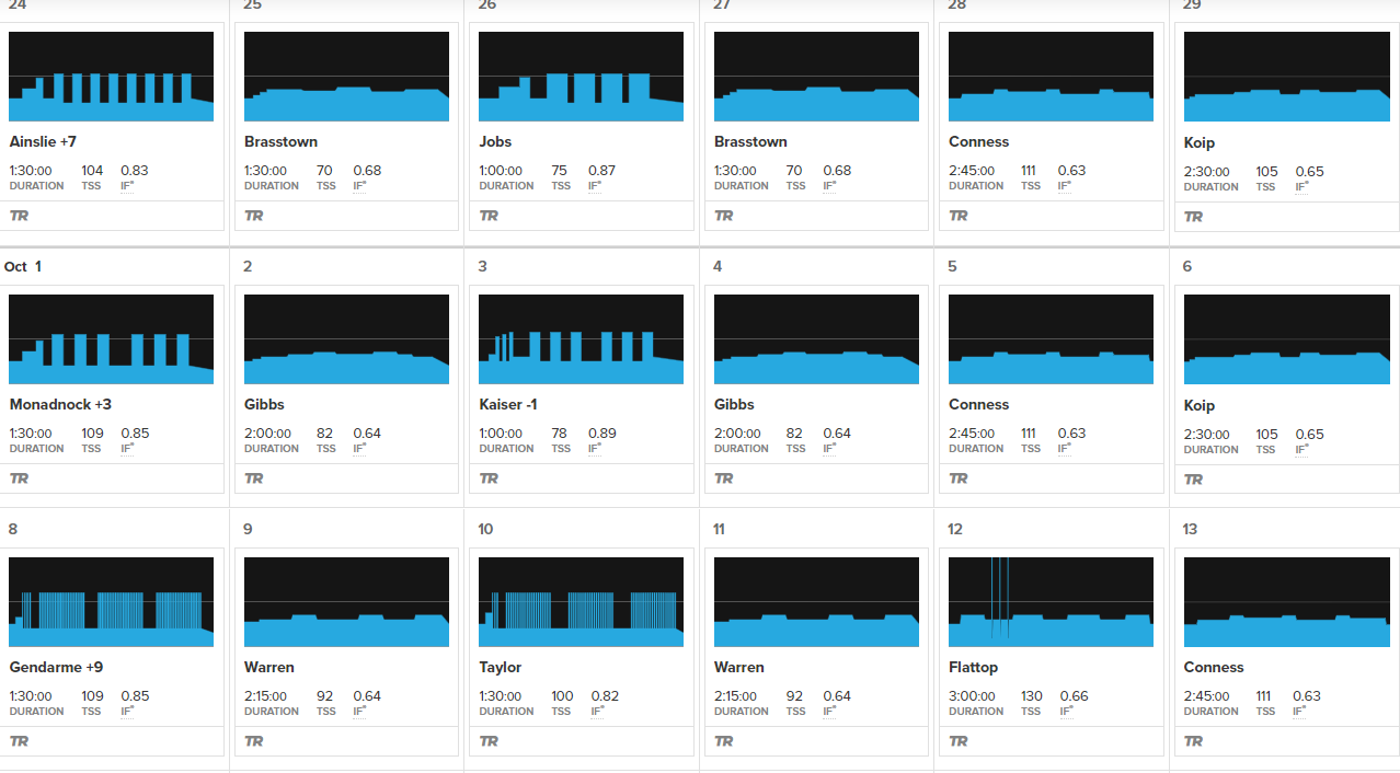

Any suggestions for how to work in different interval duration workouts? Scatter them, increasing duration, decreasing duration? Does it matter at all or can I just do what works based on my schedule? Anything I’m missing from the general approach from you polarized experts?
I very quickly put together this three week block - any thoughts or suggestions?
I would usually go with coach Chad’s way of going short intervals and progressing to longer ones, but it really depends on what you’re shooting for.

My understanding of the Polarized model is that it is about doing the time at VO2 more than the duration of the specific intervals. I could very well be wrong, thus my question. I’m not really sure if there’s benefits to progressing the duration other than your own ability to complete the intervals. I guess even if that is the main benefit that isn’t nothing - might change up the order.
My thinking was to give this a trial run now and see how my body responds to 4 or 8 weeks of this approach (typical 3/1 work/recovery split). Then, go into a true break before putting together my actual plan for next season
