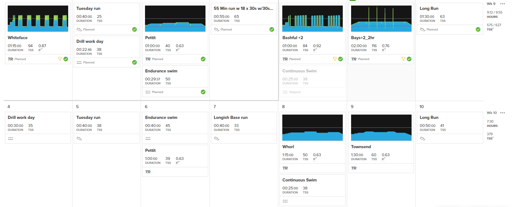

So I just finished up my 3rd week of a customized Xterra tri plan. It is somewhat polarized in the planning, in that the hard workouts are the two weekday workouts from Low volume short power build, and 1 interval session from the mid volume OLY tri plan. Swims I’m saying we can throw out as my swimming volume has only minimal impact on my total metabolic load.
My calendar is linked in my profile if anyone wants to look at more of the specifics. I don’t plan on updating to the same level of detail that Chad did for his, but give some general updates.
Caveat/exclusion: I am not ramp testing, but self selecting the power target based on how close I think I can accomplish it. If the workouts feel right on (achieving high HR during interval sessions, and low, steady HR during Z1/2 rides) I will not change it. For this block, I had a pretty good success rate on the bike, hitting target power for most of the intervals, only the last one being a few percent off of target .IF.
So this is really only polarized since I am not doing any in-between work, but it is not entirely a high volume plan, 9 hours is still pretty much mid-volume and mid 500’s total TSS.
So you can see I definitely had trouble with Bashful +2, I’m wondering if that was a fueling issue, but then again, hitting 125% for those later intervals is going to be really hard, no matter what so not sure there was much else I could to to get to that target. HR average for the weekend rides, was 122 for Gibralter, 121 for Andrews +1 and 124 for Bays+2, even though the IF was .71, .74, then .76 indicating that fitness has gone up.
It’s really hard to track my run fitness since it is not power based, but pace based and winter weather/clothes really make it hard to get a consistent pace. When I have the 20 minute tempo run in week 7 of the build, that’ll be the real indicator of where I am running-wise. My personal best in a 25 min tempo run last june was a 6:25ish average.
What I really like about this plan is my compliance was near perfect. I only missed one workout due to my work schedule since I swim at lunch and am not always free to do one, so then there was only 1 really altered workout for the bike portion. Previously I have had a lot of trouble doing a build with TR since there is not a specific offroad triathlon plan and have had poor bike compliance, and thus never really was able to increase FTP (but was able to move the shorter end of the power curve). I plan on only increasing the FTP setting 5 watts, as the IF of the workouts in the 2nd half of build get progressively harder and I don’t want to be a hero… steady increases are still good improvements. Since I had to alter one of the workouts, I definitely didn’t have my FTP set too low, thinking it would be pretty close to where it would be if I was using the ramp, higher intensity work is just about perfect, and the lower intensity stuff is not terribly hard.
So there’s probably not going to be a huge increase from doing this compared to the standard TR format, but I think the real measuring stick will come during the race season… how close to my manually set FTP can I hold in a race. I will be targeting .9 IF for Xterra bike legs. It is also not very hard to edit a TR plan in build, to make it more of a polarized plan, pick your two hard rides, swap the rest with zone 1/2.

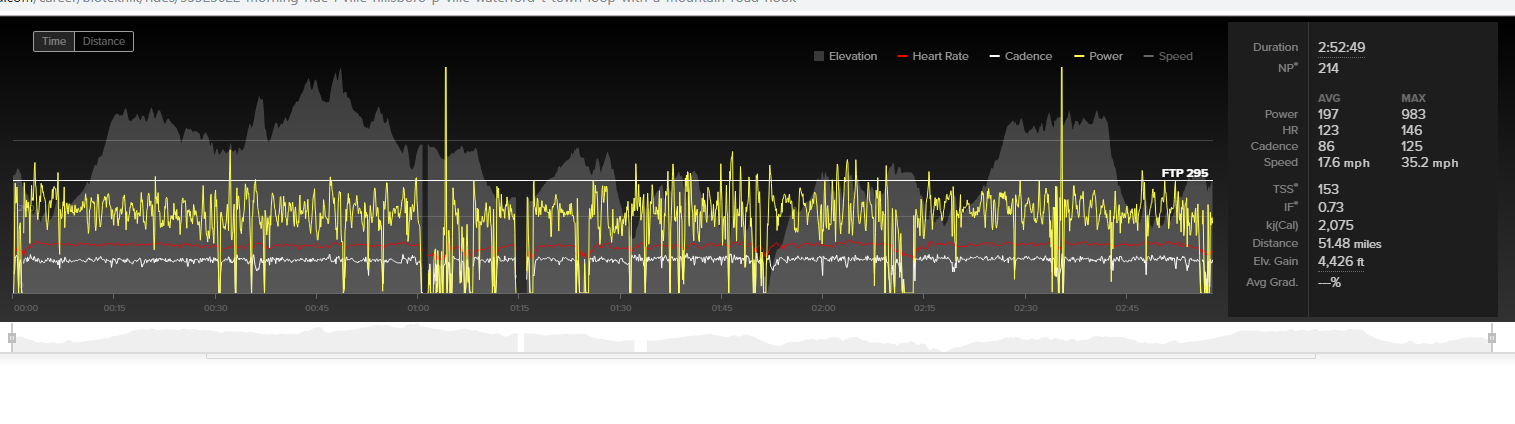

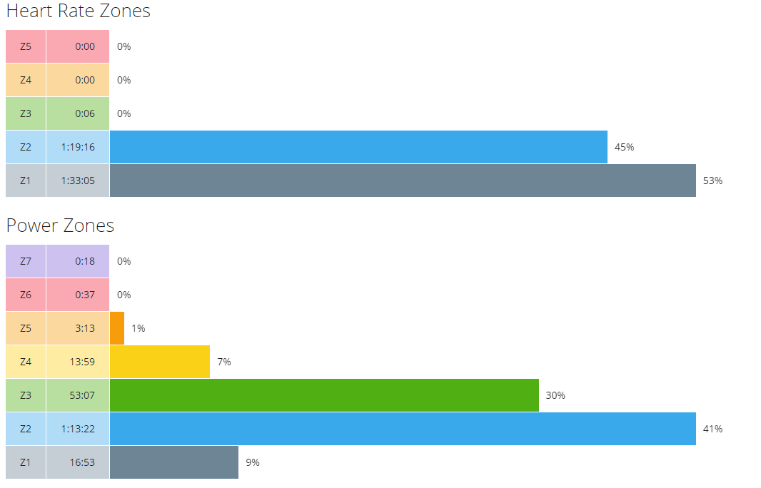

Weekend zone 2 rides were roughly 75% of FTP for main target, but would usually put me at the zone 1/2 threshold. Here’s the first endurance ride I did. It says tempo, but I did a 5% drop from the power targets since I liked the duration of the workout, but wanted to give it a slight bump down to my HR target (around 125, I have a max of 175)
And here was my most recent indoor endurance ride, slightly modified for short power, doing 4 sprints during a mainly 75% of FTP power target
And here’s the most recent outdoor ride, power/HR is going to be very different outdoors since the power demands of outdoor riding cause more spikes in power necessary. If there’s a blind turn coming up, I will hustle a little bit to get past it when I know no cars are coming, but I still think overall HR response was ideal.
Overall, I have hit TSS numbers on the bike that I was only able to hit as one week spikes, and did these consistently through the build. 300 TSS on the bike was about my limit when doing harder weekend rides, and I think also being smarter about my runs has made it possible to get an overall higher TSS.

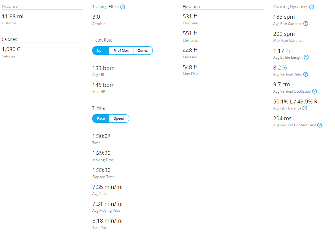

On to the run:

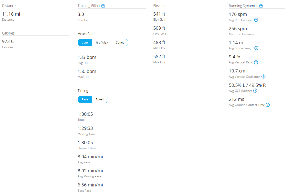

Here’s a long run from early in the build:
And now the last long run that was on pavement, a very comparable course to the one linked above. Almost 25s/mile faster at the same average HR, lower HR peak. Once again, no training in the middle zone. 133 is 74% of my max of 180 for the run. Maybe slightly higher by a few beats than people who would be doing longer, but I think that as long as I’m doing a pace where there’s almost no decoupling, that I’m going to go ahead and run/ride at that pace.
