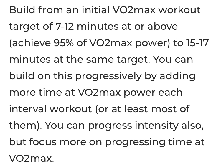

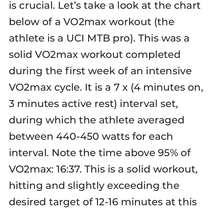

Yes. TiZ usually refers to the duration of intervals, and separately we want to track time at 95% vo2max (max oxygen uptake). I couldn’t find anything in my notes, and went looking again.
Coach Tim Cusick has an interesting article on Pez Cycling: Toolbox: Building VO2max Capacity - PezCycling News
A few key points that I’m adding to my notes:
I also pulled up some WKO webinar slides (Max aerobic, and Dean Golich intervals), going to give them another listen.
