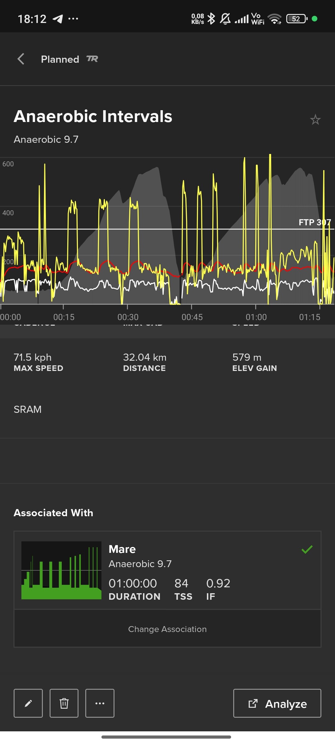

maybe my understanding lacks comprehension on the matter, but please take a look at this screenshot I just took:
If my math is indeed mathing, then 12.8 (workout target level) - 8,7 (current progression level) = +4,1 which does not equal the expected progression level increase of +1.3 stated within the text?
Isn’t that a bit off?

Hello Caro,
This seems to be not the case, when you complete a 9.7 workout outside? Could that be an edge case?
I’ve just completed the prescribed workout successful but this time it did not trigger any adaption even tho being in that build phase.
Note: I went really exited home in anticipation for another FTP update to be then ignored by the system :laughing:

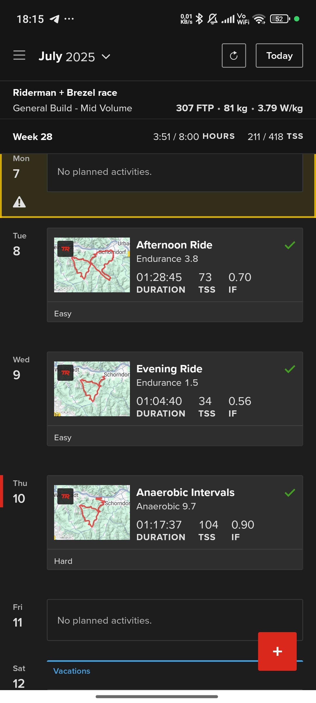

Hey @Vrakoss, definitely feel ya on the excitement to get an AI FTP Detection to only have the system ignore it! haha. Nice work though!
When completing a Level 9.0 workout in the Base or Build phase may trigger an AI FTP Detection. In this case it looks like it didn’t…
Looking at your Calendar this may be because you’ve completed two Anaerobic workouts already (level 9.8) on June 19th and June 27th, where you did trigger an FPT increase.
I see.
Thanks for coming back with an answer. Next week is another one scheduled by the system of level 10.2. I’ll do this one indoors and hope for the best.
