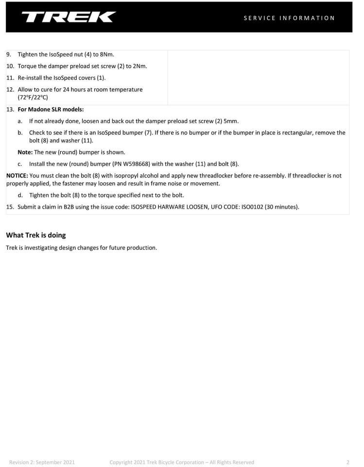

Hi all - the attached is the Retailer Bulletin about this issue, taken from the Madone Owners Facebook group. Note it specifically mentions Loctite 263 or 2701 (high strength).
Thanks Fobundy that’s a great help.
