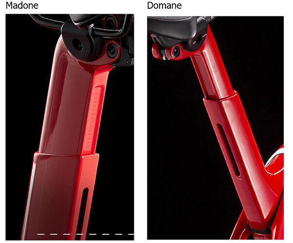

Is this something specific to Madone frames and ISOspeed implementation? Or would other Trek road bikes that have ISOspeed theoretically have the same problem? It seems like everyone here is talking about Madone, but know there are a lot of other Trek models that use ISOspeed
This is less about Isospeed (but definitely related) and more about the specific seat mast and seat mast cap implementation here (specifically the seat height retention system). Some of the Domane models have seat mast and retention system with similarities, but I have not seen the same level of issues on that side.
Not sure if there are notable differences between them or if it’s just an issue about who has them and shares issues about them in different places?
While the seat height retention system may be having issues, ISO Speed is definitely the issue here. The problem stems from the retaining bolt loosening, and then causing cracks in the frame. Have a look at the pics earlier in the thread. Mine had exactly the same problem - a crack in the frame around the ISO Speed bolt hole on the non-drive side.

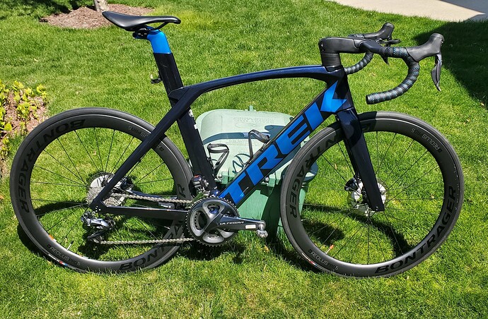

After about six weeks of waiting, I finally got my Madone with the new frame, replaced by Trek, and with an upgraded handlebar. I took it for a 15 miles ride today - yeah, that’s my bike alright. The new handlebar seems to be extending a bit further ahead so I feel bent a little more forward. They left the original seat post of course but luckily it matches the lettering on the new frame, so almost as if it was on purpose.
