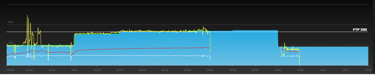

Tried the baseline protocol today and it didn’t go as planned.
2 things that made this a learning experience;
It’s still 77° in my garage which isn’t too bad but I started feeling very hot 15 minutes in. Even with fans blowing on me. Winter temps in Florida right now are like summer temps in Canada.
I was trying to compare my Tacx Neo to my power pedals. So I was looking at both my computer and iPad, next time I need to use 1 power source to help pace better.
This was the first time I’ve ever tried this test, so I was using it as a learning experience anyways.
I feel I’ve been improving and was hoping for an ftp bump. Not sure what to do, I just recently did 4x9 @ 108% of current ftp. I might just keep my ftp as is or add 5 watts. I was hoping today’s test would confirm but it only confirmed I need to try the test more frequently or even use it as a workout. Thought I’d share my first experience. :poop:

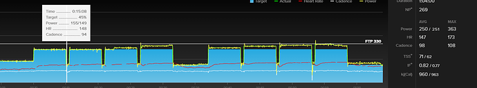

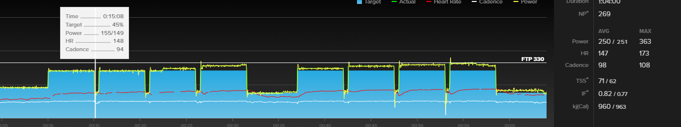

Basing the 5 watts on my performance with workouts I’ve completed. 4x9 at 331 watts is about 107% my ftp. Maybe I’m wrong, I’m just guessing based off 36 minutes TIZ with work I’ve done.

I got ya, I didn’t complete it made it to almost 25 minutes. From my previous post, I was comparing 2 power meters (Tacx Neo vs pedal pm) which I never usually do.
So I think with staring at 2 different numbers my pacing was off. It’s the first time I’ve attempted this test and so I should stick to 1 power meter from now on.
So if your were following the baseline method, you didn’t manage to finish the 15 minutes at target ftp? I’d say that highly suggests the target is too high, but if you were surging/easing to try and match power it might have taken more out of you. I’d personally knock a few watts off, train for a month and retest after doing some longer intervals to get an idea of what to aim for next time :+1:
