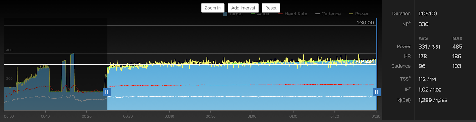

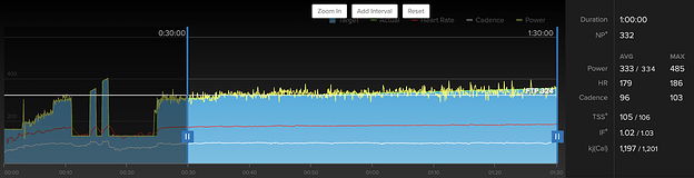

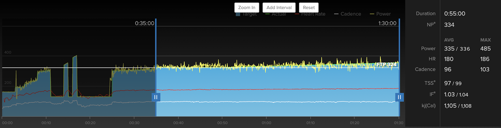

Did 310 watts for 10 minutes then raised to 330 watts based on couple of efforts I did in the end of last block.
