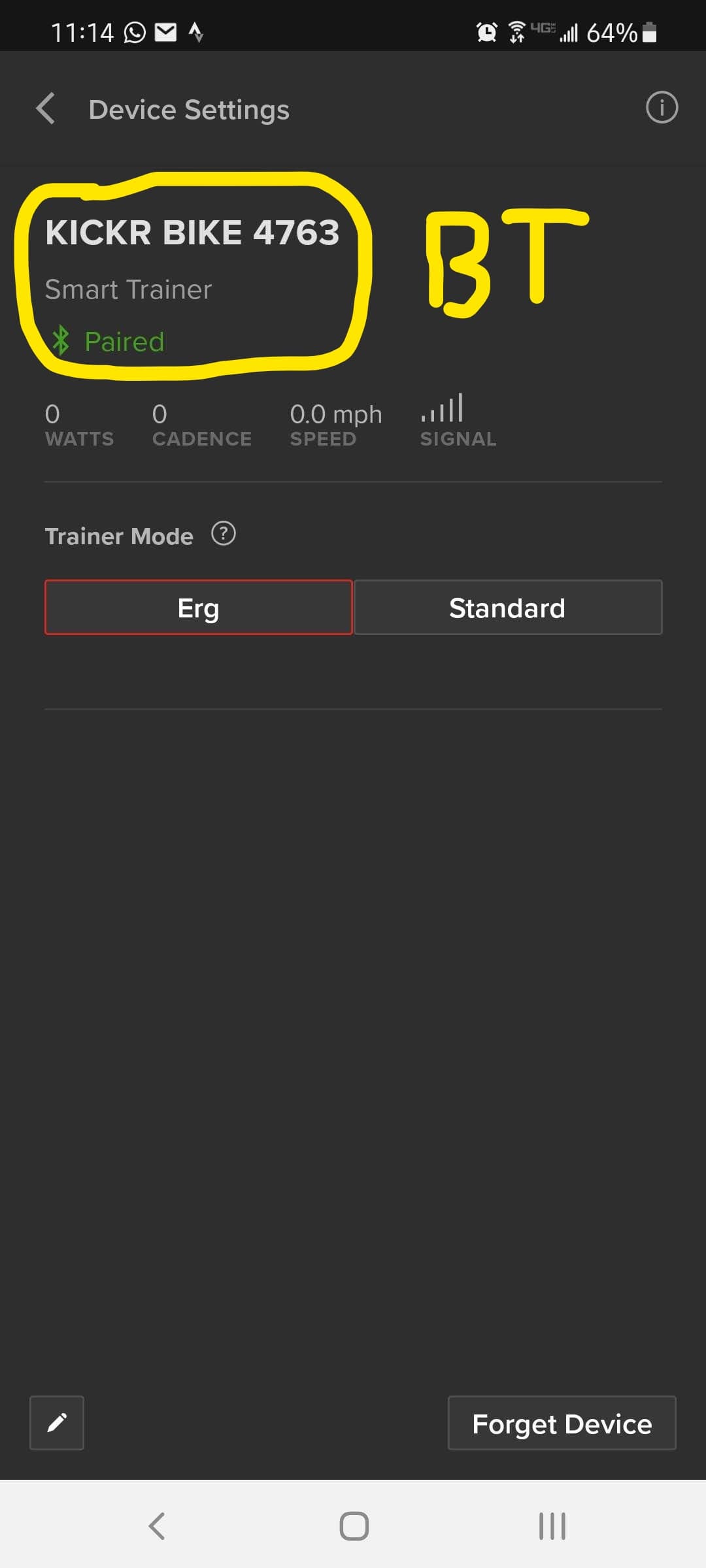

I am looking for some advice on how to set up the Kickr bike to use with TR.
Coming from a fluid wheel on dumb trainer with Favero Assioma pedals, this is my first smart trainer and I am still trying to figure out the best setup for the indoor season.
I am not concerned about power matching and/or differences between Assioma and Kickr bike, this has been addressed by many other users. My question is whether I should I use the BT or the ANT+ connection? The BT has ERG and Standard mode, while the ANT+ has ERG and Resistance modes. Also the ANT+ allows for calibration, while the BT connection does not. I have tested each of these modes using my Galaxy S20 phone + TR app. For a more accurate comparison, I did the same workout (West Vidette +1) on four different occasions, each time trying a new configuration.
  1. BT + ERG mode worked fine, with some minor fluctuations around the target power. If I increased/decreased my cadence, power was jumping around for a few seconds, but eventually settled close to the target. I assume this is normal functioning for the ERG mode.
  2. BT + Standard mode. It seemed that TR was trying to control the bike to adjust for the target resistance, but there was a lot more fluctuation in power/resistance compared with ERG mode.
    In both BT modes I deliberately decreased and increased my cadence to (subjectively) assess how TR controls the resistance to adjust for these changes. ERG mode was really nice, but Standard worked too.
  3. ANT+ ERG mode. Worked just as well as the BT+ERG mode, had zero issues in adjusting the resistance.
  4. ANT+ Resistance. Absolutely useless!! Resistance was not adjusted by the software. I tried changing my cadence, shifting through the whole gear range, but nothing helped. For all these changes after an initial small increase in resistance for a few seconds, it eventually dropped to the 60-90 watts range.
