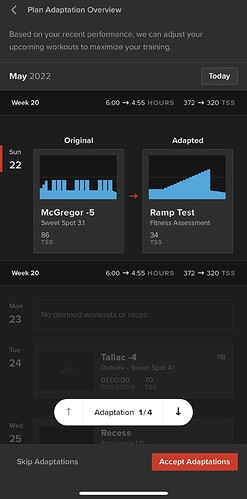

Is adaptive training trying to kill me !? [Resolved ✅]
So adaptive training really is trying to kill me :clown_face:
Another day another ramp test :man_facepalming:t3:
This is getting silly :laughing:

I had something very similar happen.
New to TR. Added a plan midway (with start date backdated to Nov-21). Got a ramp test. Skipped it.
Got another 1-2 weeks later. Did it. Didn’t have another scheduled for at least 4 weeks. On a Thurs deleted a C event (Sun) in the middle of a block. Ramp test drops in. I curse, try AI detection. It refuses me (16 days from last, sufficient workouts logged etc).
I contact support. They curse. Give me new FTP. I so the workout that was originally there (fortunately had written it down). Everyone is older and wiser.
Bottom line… AI FTP is still a bit buggy. We’re gonna see edge issues like this and should contact support. They’re very helpful.

Update: This issue has be resolved where AT would assign a Ramp Test even if you recently completed one.
You shouldnt see that issue anymore, but if you do, certainly let us know!
