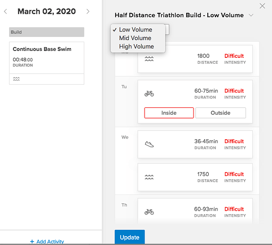

Hey @Fassi, here are some screen grabs explaining:
First, find the start of a new block. Here, I have the start of my Half-distance Build block as notated by the gray text box appearing above the day’s workout on the first day of the week. Just look for this gray rectangle stating the periodization step you are on (base/build/specialty) and click on it. Clicking the box will create the following popup:
As you can see from the drop down just below the plan title, you can adjust volume here. You can also just drag and drop the days themselves to change your weekly schedule/intensity days. In the bottom left is an option to “+ Add Activity” if you had a new race come up you want to add into the builder. All you have to do after that is hit “Update” at the bottom.
Keep in mind though that if you have already moved UNCOMPLETED workouts in your calendar they are disassociated from the builder and I do not believe they will move. They should stay put where they are and you may have to manually adjust again.
Hope this helps. Cheers.
