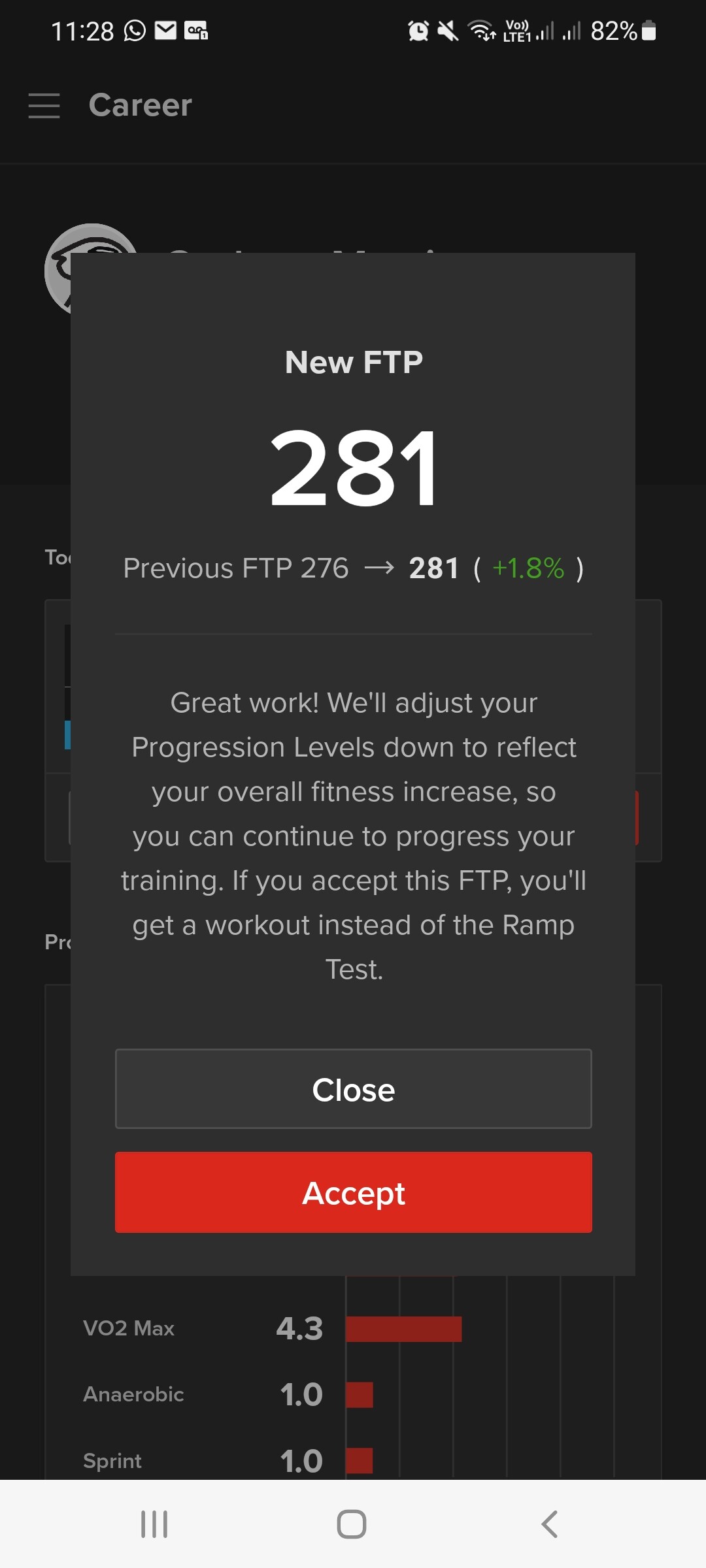

Had a little look to test, and also thought about what my FTP might be beforehand.
Bang on what I had expected. I would probably have gone for 280 dead had I been updating my own (obviously that is basically the same as 281…). The 276 was probably a bit over for a while due to time off, so ny actual improvement has been more than that.
Didn’t accept as I am mid block, wanted to go through the progression to the end.
