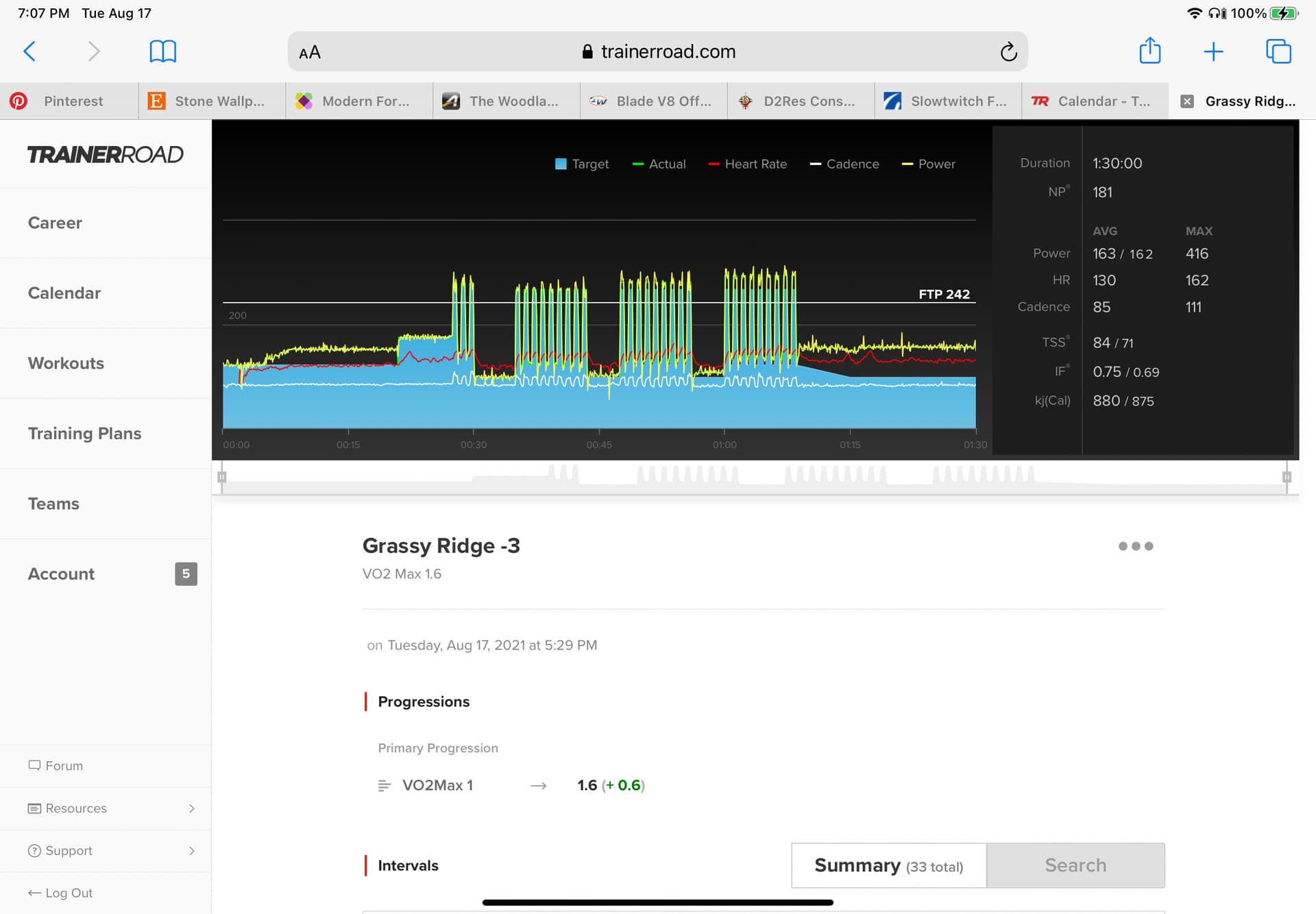

How do you know if you have a super pass and what happens when you do get it. I went with the adaptations recommended by AT. The 1st set of 30/30’s were a joke. 2nd set was up 5% and still too easy. 3rd set up 10%. My progression went from 1 to 1.6 just as if I had done the workout at 100%.
I haven’t seen them announce any SuperPass functionality yet. I’m not sure it’s in place. I may be wrong, but I would hazard a guess it’d come when the machine can analyse any ride.
It was definitely in a while ago (search to find my posts WAY above related to my issues with it). No idea if it’s still live or not though?
