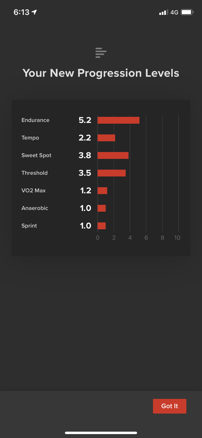

Question - are progression levels meant to RESET and/or REDUCE after you take a ramp test?
I completed my ramp test a few days ago (+8.8% woohoo for me!), and straight after I was shown a screen with my ā€˜new progression levels’ (which looked very similar to my previous progression levels).
But then I noticed this morning that they had all gone backward again - this screen shot is this morning.
Did something go wrong? Which progression levels are right?

That’s right - the difficulty of the workouts is relative to your FTP isn’t it so it follows that if your FTP is increased, your PLs will reduce correspondingly. Seems counterintuitive but it makes sense - I had the reverse experience when I set mine down after I got in; my PLs increased a lot after I reduced my FTP. If you think it through, if I was recently completing e.g., Sweetspot 6.0 at my old FTP, and I drop my FTP by a few %, it stands to reason that I should now be able to complete harder sweetspot workouts than I could manage at my old FTP. Vice-versa for increases.
Otherwise you’d go into your next block with a higher FTP AND workouts at your old PLs, which would be a recipe for failure… e.g., a Sweetspot 6.0 workout today at my new 285 FTP is going to be a lot harder than the same workout yesterday at my old 275 FTP. My fitness hasn’t improved overnight - I have just changed an arbitrary setting in the software. Hopefully an illustrative example…
Yeah thanks man, that makes heaps of sense. I think the confusion for me was that immediately after I completed my FTP test and accepted the new (higher) FTP, it showed me my new progression levels (first pic above), which I think was actually an error. For some reason it took a few days for them to reset back to 1.0 across the board.
