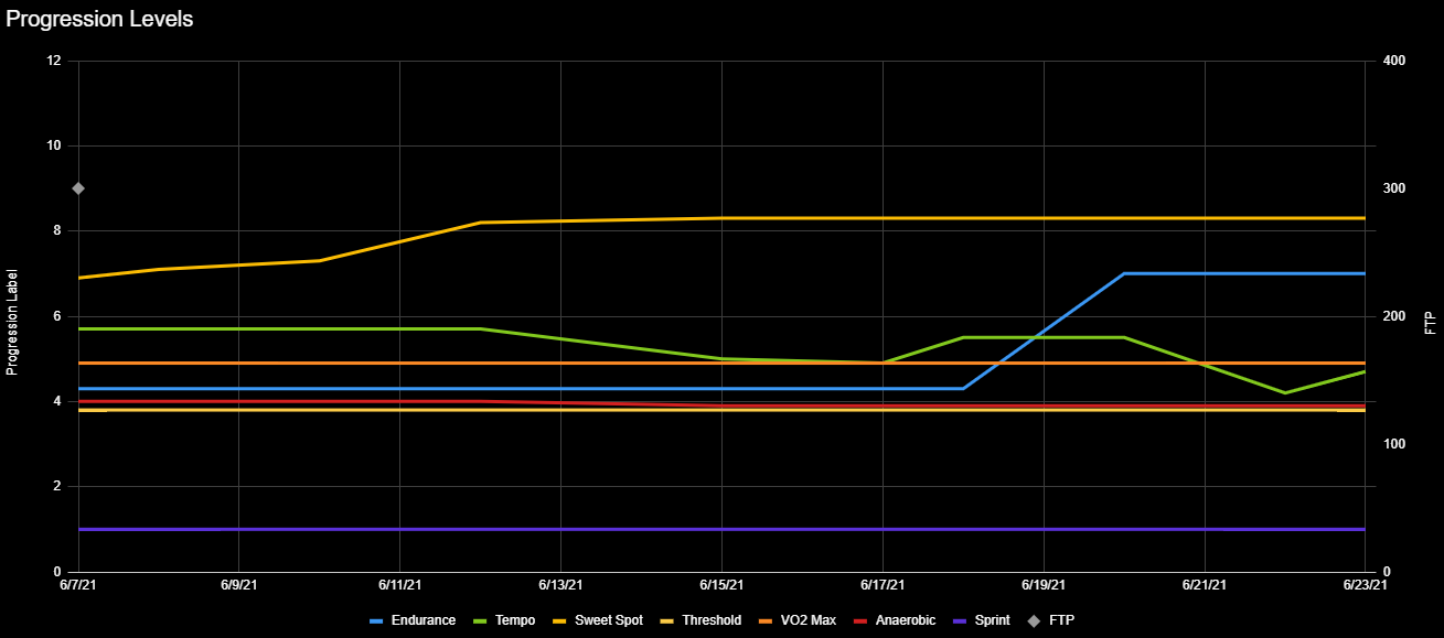

I setup a simple Google spreadsheet to track changes in my PLs because I was curious. I do not believe TR has any graphs or analytics developed but I would think they are recording the level changes to troubleshoot / develop AT. Will post screen shots in a little bit.

@kitenski here are the two charts I’ve created to graphically show changes in my PLs. The first is a TR-style bar chart for each PL, with the most recent at the bottom and the oldest at the top of each group. The second is a Garmin Connect themed line chart showing the same data.
