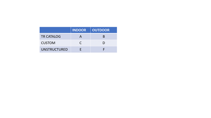

@IvyAudrain, I think in beta we’re still in the world where there are differences between what happens in different scenarios. Seems we have six categories of workouts on 2 different dimensions in our world – workout source, and how it’s ridden. Being a bear of very little brain (AKA Winnie-the-Pooh) I’m easily perplexed. I Just sketched out this grid to help me think through that.
If this represents today’s reality would you and your TR colleagues be very clear to which of these scenarios your comments apply? Thanks!
Edit, ah, forgot the Garmin/non-Garmin issue too. Probably means three location columns: Indoor on app, Outdoor on Garmin, Outdoor on non-Garmin. Nine-cell grid, yes?
I think your grid doesn’t show what is really happening, as you there are two higher levels:
  1. Completed workouts - which scenario(s) contribute to PL
  2. Future workouts - which future workouts on your calendar will / could AT suggest adaptations for
For example for #1:
  • there is (should be) no difference between how AT works with a completed indoor workout that comes from the TR library or is a custom Workout Creator workout. So long as the TR app is used, then these are the same
  • There is no difference between an indoor free ride / unstructured workout or an outdoor free ride / unstructured workout. Neither of these cases contribute to your PL at the moment
For #2: currently AT only adapts workouts that are part of a Plan Builder plan on your calendar. How / where you complete the workout (e.g., indoor or outdoor) is a secondary issue to whether prior to your doing the workout, AT will suggest adaptations. Once you complete the workout, you are in use case 1
Good comments. Chad was working in parallel in the beta thread.
However we end up, having this kind of view into the different dimensions and being able to clearly label what a particular comment refers to would be extremely helpful as there are so many moving parts.
