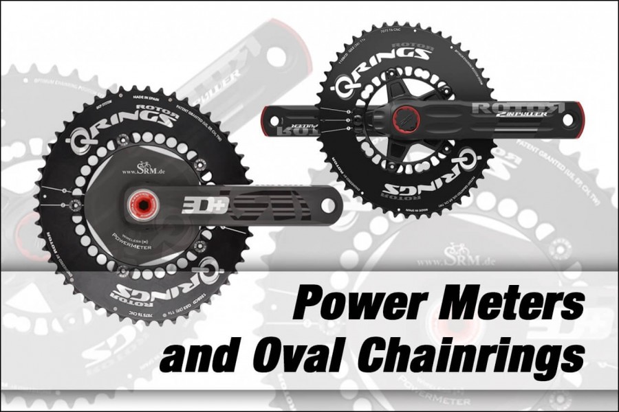

Sounds exactly like you’re describing drive train loss on top of the effect of your Q-rings. Drive train loss is ~7%, plus the ~2% skew from the oval rings and with 310W FTP that brings you to around 30w less from where spider-measured power reading is from and the freewheel of the KICKR (the PM also is +/- 1-2% accuracy as well).

Thanks, where can I read more on the 2% power skew you mention? It interests me.
The more oval it is (like QxL or Osymetric), the more skewed it is – note that this doesn’t affect your training numbers or anything as long as you’re using the same equipment (the constant offset is effectively normalized out).
Stages claims 4-5%
Others suggest 1-4%
