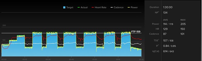

I started doing intervals by heart rate, and have some good data. So I look for improvements in power-to-HR as one indication that FTP has gone up. However HR is individual, so hard to give specific advice, and TR plans tend to make eyeball analysis harder by slightly changing interval formats.

As said above by @WindWarrior heart rate and threshold zones are a good indicator for me also. What I’ve seen is if a over under work out is not as hard as I normally expect.I either had a day I was fresher than normal or my FTP is increasing. But that’s all personal anecdote.
I find that over-unders are a good measure of where my FTP is at - the burn in your legs should be gone by about halfway through each under, obviously this point will move as the workout progresses and you tire. If you don’t get a burn or a very minor one then the chances are that your FTP is too low, if you don’t recover at all then it’s too high.
