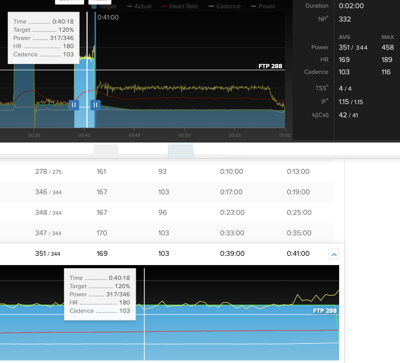

There is some inconsistency in the values displayed for “interval power targets”. I have noticed this for a long time and kept ignoring it because it makes no difference to training or metrics, but I now notice often enough to mention it.
For example, yesterday I did South Twin -1 (2min intervals at 120%). The target value for the interval would therefore be FTP*1.2 = 288W *1.2 = 345.6W
  • The workout displays a target of 346 W on the web and during the workout…seems plausible for a calculated target, assuming it rounds up.
  • The summary that shows up on-screen after each interval reports a target of 345 W…looks like we rounded down here?
  • The interval summary when I analyze the ride on the web says 344 W target…not sure how we got to 344 from 345.6?
Clearly this is not an urgent issue, but curious if it can be addressed at some point. It’s especially distracting during a ramp test where you try hard to stay exactly on target. Again, I know 1 watt doesn’t matter :slight_smile:

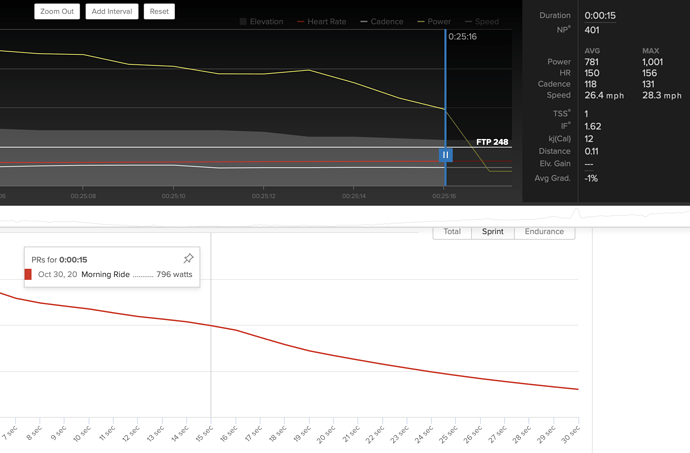

More fun on the web interface - pull up a ride where you worked on sprints. Use power duration to select best 15-second power, and now checkout the summary (upper left):
Since when did 796W equal 781W?

This is from Bluebell the other day - FTP 284, target values on the PC app were reported as 341 (rounded value of 284 * 1.2). Then you go to analyse the workout and it says the target was 337. Note this more closely matches what I actually hit using ERG mode, so maybe there’s inconsistency in what ERG mode is asking for too! But 341 would be closer to the desired 120%. Sure, a few watts between friends doesn’t really matter, but at the very least it should be a consistent value wherever it’s used and displayed.

I now wonder if they have the “window” used for average shifted by 1 second or if they are including 1 sec after (or before) the effort in the calculation. Both of these would get you to 344W…doing this weighted average with the South Twin -1 example:
(345.6W* 119sec + 115.2W * 1sec) / 120sec = 343.7W
I think it is something that should be fixed, as reporting inconsistent numbers can annoy anyone who notices it.
To make this hypothesis more convincing, I noticed it’s only the final interval of an over-under set which is affected. Selecting it, you can see the power target (green line) does include one point at the recovery power level.
Same story if you zoom in on the “under” portion - it contains 1 data point from the “over”, but the values are close enough that it does not affect the calculated target value. 36:00 to 37:00 is actually 61 data points, not 60.

  2. Target power calculated on the web uses a window that includes a data-point from the following interval in the average.
Thanks for bringing this up! We’re looking into this now with the new apps to see if the differences are there too.
For the second issue on the web, it is a known issue with the web calculations and we just haven’t prioritized addressing that yet since the differences are so small.
