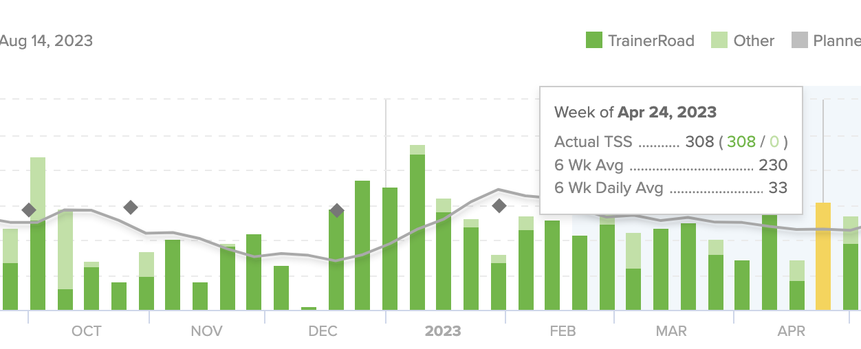

I used LV plans(SS base - Sustained Power Build - Gran Fondo Specialty) till my A race in Apr. I restarted(hard reset) my training back in Feb 2022 and started with 150~160W / 58kg. At the time of my A race, I was somewhere like 205W / 61kg. My typical training hour lays about 3 to 7 hours per week. Sometimes whole week wiped away, sometimes only two workouts done in a week, but try to do more when possible
Above - OP, Below - Mine
Without the exception of Amstel Gold Tour(which seem to skew the meaning of 6 Wk Avg), OP’s CTL(sort of) is tend to below 200. Workouts done are sparse across the calendar. POL LV? Short of stimulus, I think… I might say “different use of LV plan” lead to OP’s suboptimal result compare to me.
