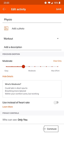

I was wondering if there is a good way to track and record a gym session and send it to TR for inclusion in the calendar and overall TSS (with approximate value based on heartrate or RPE).
I have tried to use the Jabra Sport app (comes with the Jabra Pulse headphone / HRM that I am using) and send the data via Strava to TR.
The problem:

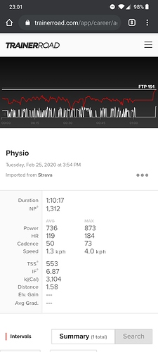

While the data in Strava makes kind of sense, even if it seems a bit high (circa 600 kcal per hour), TR shows the same workout as more than 3000 kcal for no apparent reason. I’ll try to attach a few screenshots below.

TrainerRoad is reading it as a cycling workout with over 700 watts average power, that’s why it’s saying 3,000 calories.
What sort of workout is it? I believe right now the only way to add in a non-cycling workout to TR’s calendar is to do it manually.
I use a polar watch for HR in the gym. This sends the session to strava. I also use intervals.icu, set to import workouts from strava. With the HR information, intervals.icu calculates a HR-based load [like TSS]. All of this is automatic.
Then, as Geronimo says, add the activity manually to your calendar with TSS set to the intervals.icu load. This is the only manual part.
