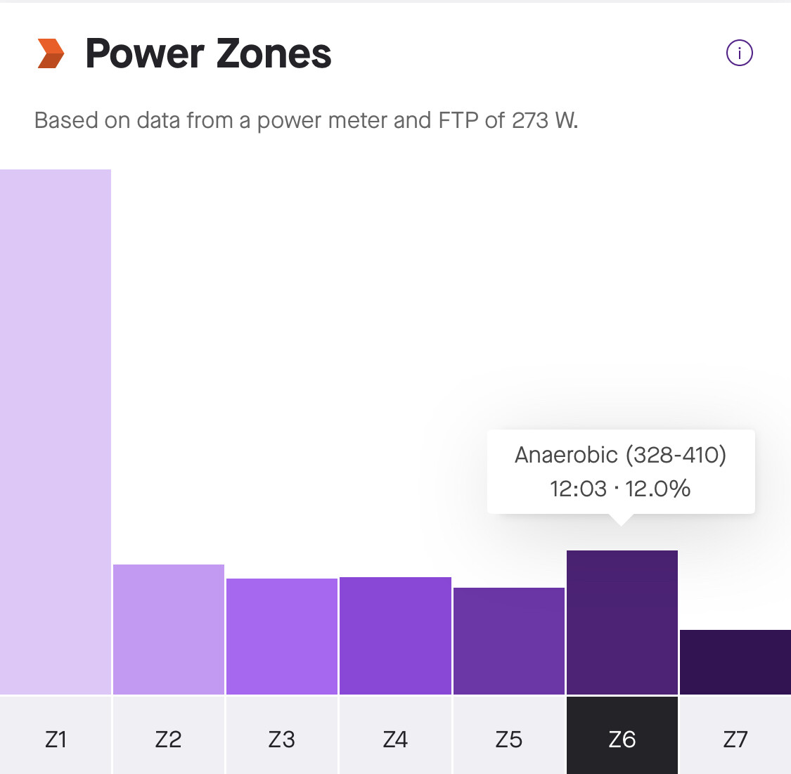

Most TR plans ignore anaerobic, but I often do highly anaerobic rides on single track, which are intense compared to TR workouts indoors.
I know there’s functionality not released yet to take these rides into account in progression levels. With current functionality one process that makes sense to do this manually is to:

The below is 17% anaerobic, and 10% VO2. What kind of workout do people think this should be matched to?
The options are limited for anaerobic, and because of the low workout levels of these workouts, secondary adaptations to VO2 are unlikely. Everyone doing SSB etc seems to have low PL’s for Anaerobic at 1.0.

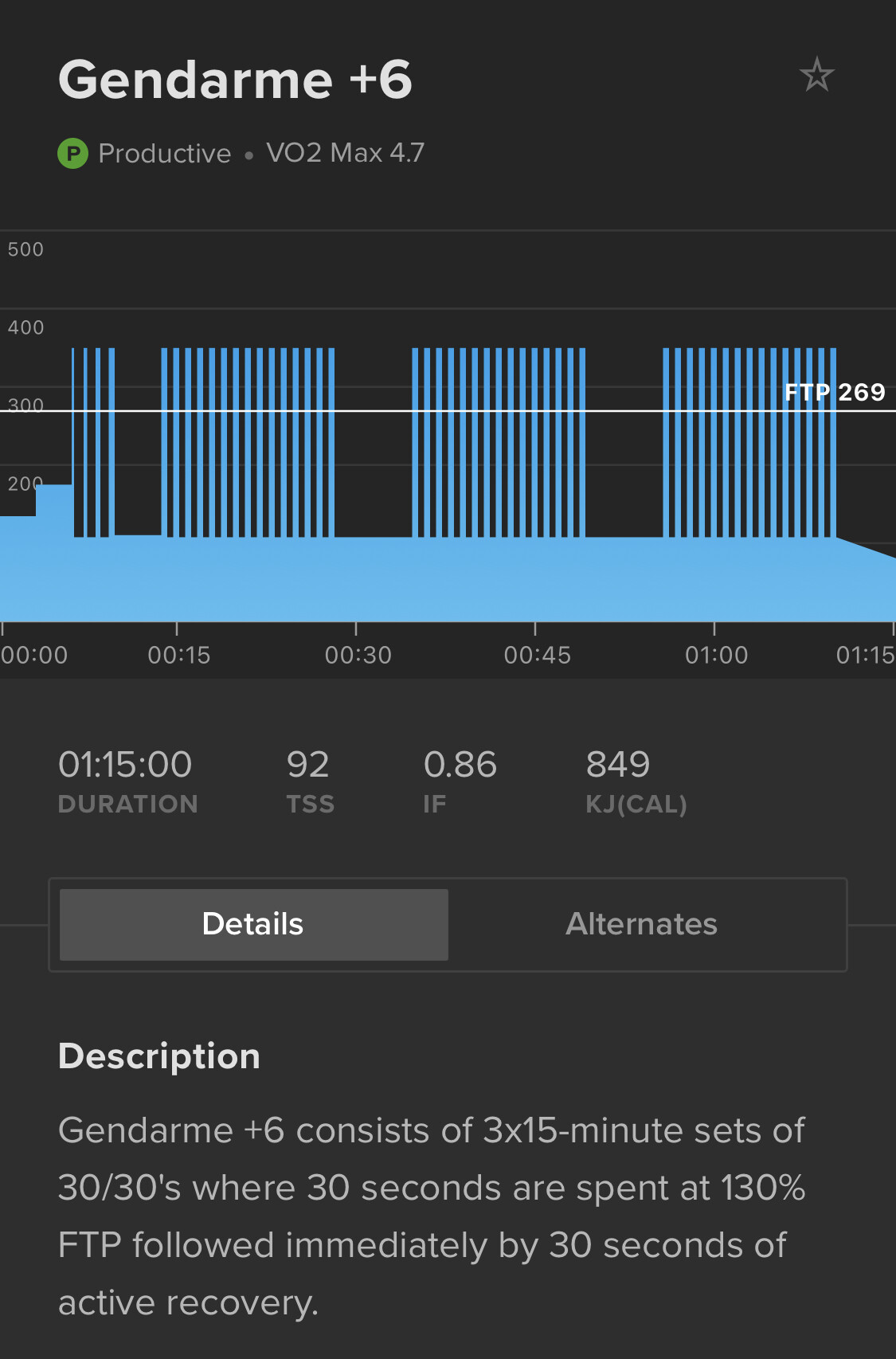

The VO2 approach would be to focus on associate this outside ride with a VO2 workout, to maximise relevance with the progression levels active within the plan.
Combining the anaerobic and VO2 ‘time in zone’ would mean choosing a VO2 workout to associate this outside ride with.
The time in zones (VO2 and over) is 27% of 90 minutes; 22 minutes. With this logic, I should match with a workout with approximately 22 minutes of time in VO2 zone. This produces vastly different adaptations, ie it actually triggers adaptations in VO2!
I associated some of my Zone 3 paceline rides with a workout of similar duration and IF. Some times I filtered it further to a similarish profile. I erred hopefully on the cautious side by just selecting workouts that were ‘achievable’ just to stop my Tempo PLs degrading. The Paceline rides are maybe improving me but I decided that associating them to a ‘productive’ or ‘stretch’ workout could possibly lead to overtraining.
