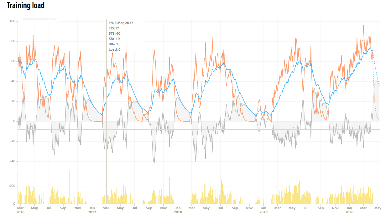

Ok, the above numbers I quoted were from Strava, and the manually entered FTP. From intervals.icu:
Second peak of 2019 – the CTL was high, as was the FTP (I also did that at 71 kg). But, I felt fried.
End of 2019-20 Winter Base. Muscle added from rowing and the gym. Lots of volume, but not a ton of fatigue because of the gradual ramp rate.
First peak of 2020. FTP a little lower (but within the model’s range of error, so really no different), but 5min and 1min power are up from more muscle mass. I needed that CTL drop because the hard days were darned hard.

Ah, I see now. This is completely new to me, this is mine:
You guys are all so much more trained than I am. I am jealous. But to my credit, I have only been doing TR since October 2019, so only recently I have been training very structured and systematic. Hopefully the gains will come!
