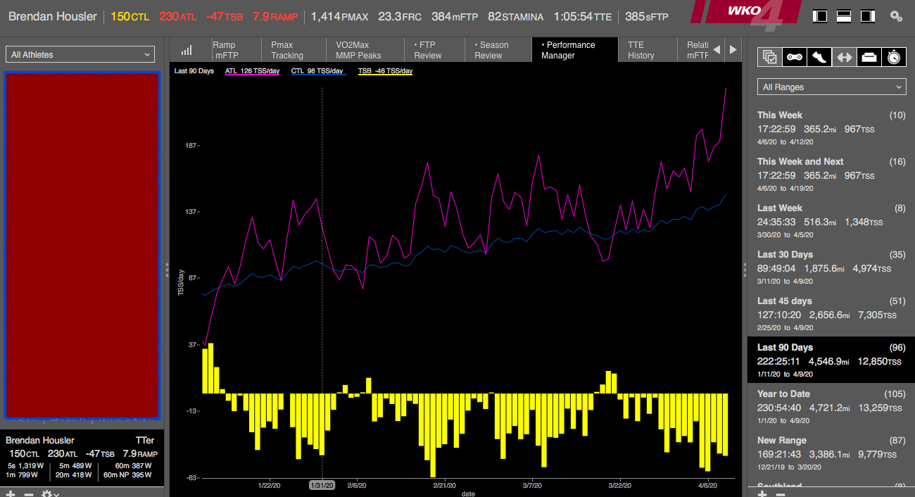

It’s my 1st year tracking CTL and other training metrics.
My graph looks like a big long steady ramp.
In your experience how high can CTL go? Is there a limit?
You ride a lot! I guess it could go as high as you let it, it’s based tss per day in a simple sense. If you ride 300 tss every day it could go that high!
You aren’t resting enough for what it’s worth. Been negative TSB very Long time.

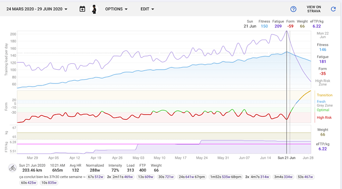

Are you sure your weight is set correctly and your power meter is working OK? FTP of 400Watts / 6.2W/kg is pro level! Respect anyways for the hard work in the last months. Looks impressive.
Thanks. Yes weight and power meter are set OK. Pro is the target ![]()

Most pro’s take their CTL up to 120-140 not counting stage races athletes. You should avoid going -30 as you burn out or overtrain. You must be young or your FTP is set incorrectly or are a genetic freak to have a 200 ctl.
You think his FTP is set too low then? (A low FTP will artificially drive CTL high)…Also, I’m not familiar with this software. I’m seeing fitness (CTL) of around 150. Fatigue or ATL is around 200. Am I interpreting this wrong?
Anywho, what caught my eye was the normalized 288W for 200k (6 hours). If solo this to me back up this dude is a badass and 400 FTP would be totally acceptable. JMO
I think his FTP is definitely in that range based on the 288 for 6 hours. (these are pro tour numbers) The statement was just a list of reasons why CTL could be incorrectly driven up. He is putting down a lot of KJ’s and it looks like with a little bit of intensity in there too. In Matt Fitzgeralds book and what I have heard other coaches say, CTL at 200 will eventually break someone.

Not disagreeing with the message just questioning the CTL of @_JG being 200 . I’m seeing for the 21st fitness (CTL) 150, fatigue (ATL) around 209 and form (TSB) -59. While high and not possible for most, 150 in conjunction with all the other data is human. May or may not be advisable either, just commenting that it’s doable if that’s a goal.
Agreed
