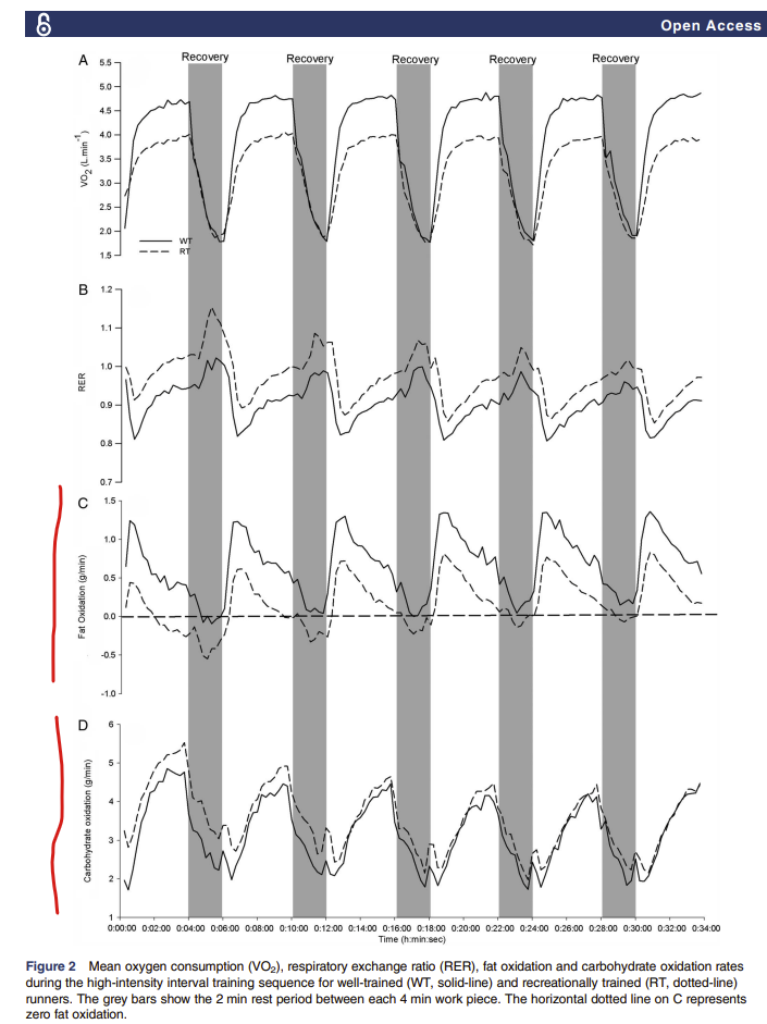

yep, the thin lines are the conitnuous measurements, the thick lines are just crude smoothings. We can see how fat ox kicks again in after ~5min after the effort. There is some lag. We see this with the two all-out efforts nicely. In the first minute or so of the second all-out effort fat ox is still elevated.
Fat ox/carb ox do not change instantaneously with changes in power. Here a nice graph from a study on HIIT (Hetleid at al., 2015), 4min intervals with 2min rest. Almost half of the 4min work interval is fuelled with high fat ox
Two notes on the previous graphs:
  • they’ve observed this elevated fat ox repsonse after these all out efforts in for more than 2 hours after the efforts
  • it does not have to be an all-out. You have to bring yourself into an oxygen debt/defcitit (never know what is what)
