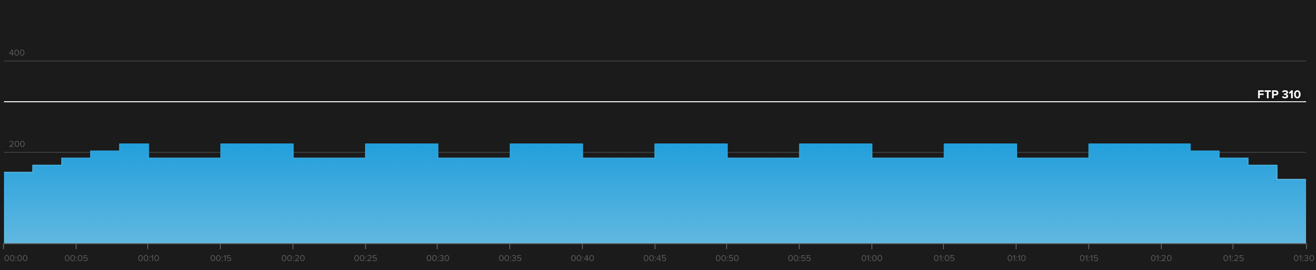

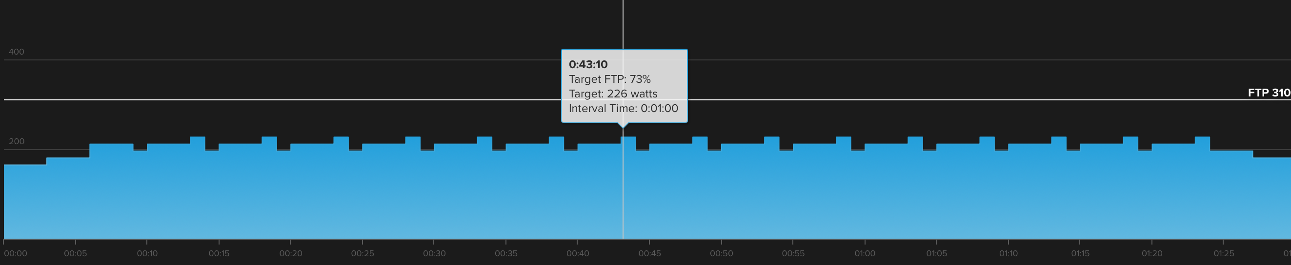

One thing I’ve noticed with these polarised plans is that TR’s z2 workouts are all extremely monotonous when done indoors.
It’s possible to still have intervals within a z2 workout which (for me at least) makes the time go faster as you mentally split the workout into chunks of effort.
Example workouts from non-TR plans to explain what I prefer:

Take it out of Erg, or do them in sim mode on RGT/Zwift/etc.
Those intervals must be a mistake surely?
