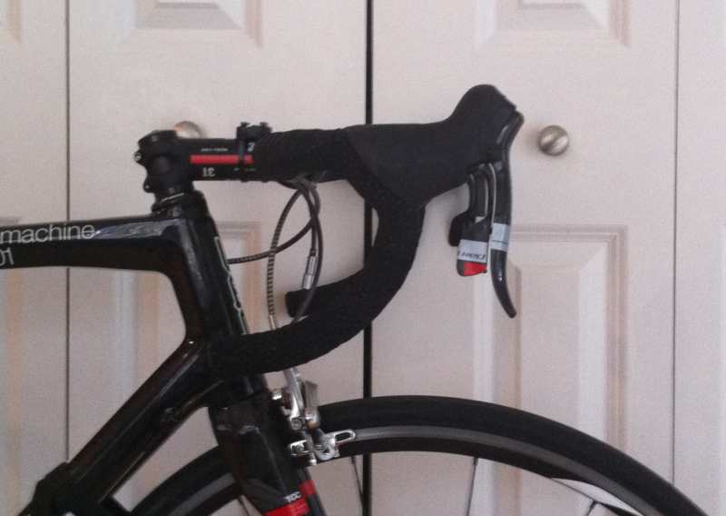

As a starting point, I usually point the bottom flat part of the bar downward a bit from horizontal. Then, I position the levers so that there is a flat transition to them from the bar’s ramps. Bars that have a sharper bend in the hooks near the ramps work better for this. Ideally, when done, the tops ramps, and hoods fall in one plane. This works well for me. Here’s pic of one of my bikes from 16 years ago.
