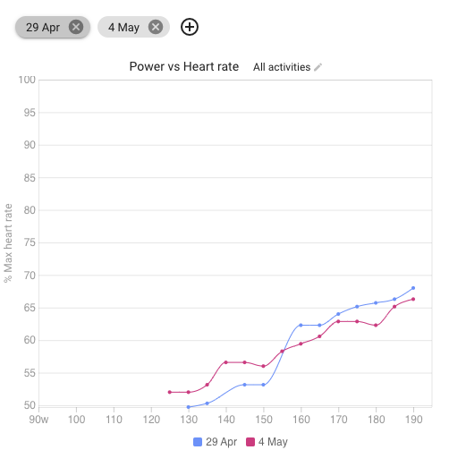

I just did the first session on the TT bike in over a year, and was surprised my HR stayed so low. On the one hand I am leaning on the arm rests, but on the other I am in a pretty low position with restricted breathing. Here’s the data from today’s session with a Z2 road bike session in blue:
Better late than never…lol. In general mine is lower while riding the TT bike at the same power as well. While I don’t know for sure I think it’s due to less upper body and core muscle utilization while riding the TT bike. Less utilization due to being supported by the arm rests.
Mostly my HR on a TT bike will rise to about the same as on a road bike I could be wrong but I think my HR raises faster and less sustainably sometimes on a road bike and its probably affected more by cardiac drift too. Ive never actually looked at what they (TT HR & Road HR) are doing at the same power though but I’d guess on the lower sustainability of the road bike means that the HR would be higher if I was achieving the same power as on a TT bike.
