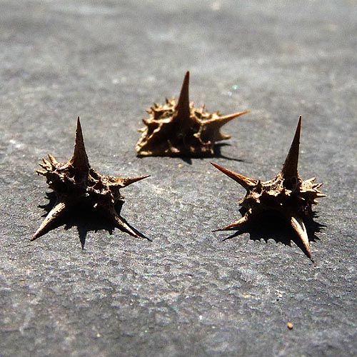

The big win for me is what I call “the tubeless miracle” of avoiding the 1-3 flat repairs a month once early summer arrives and the goat head thorns are out in full force for 6+ months
goat_head_thorns
