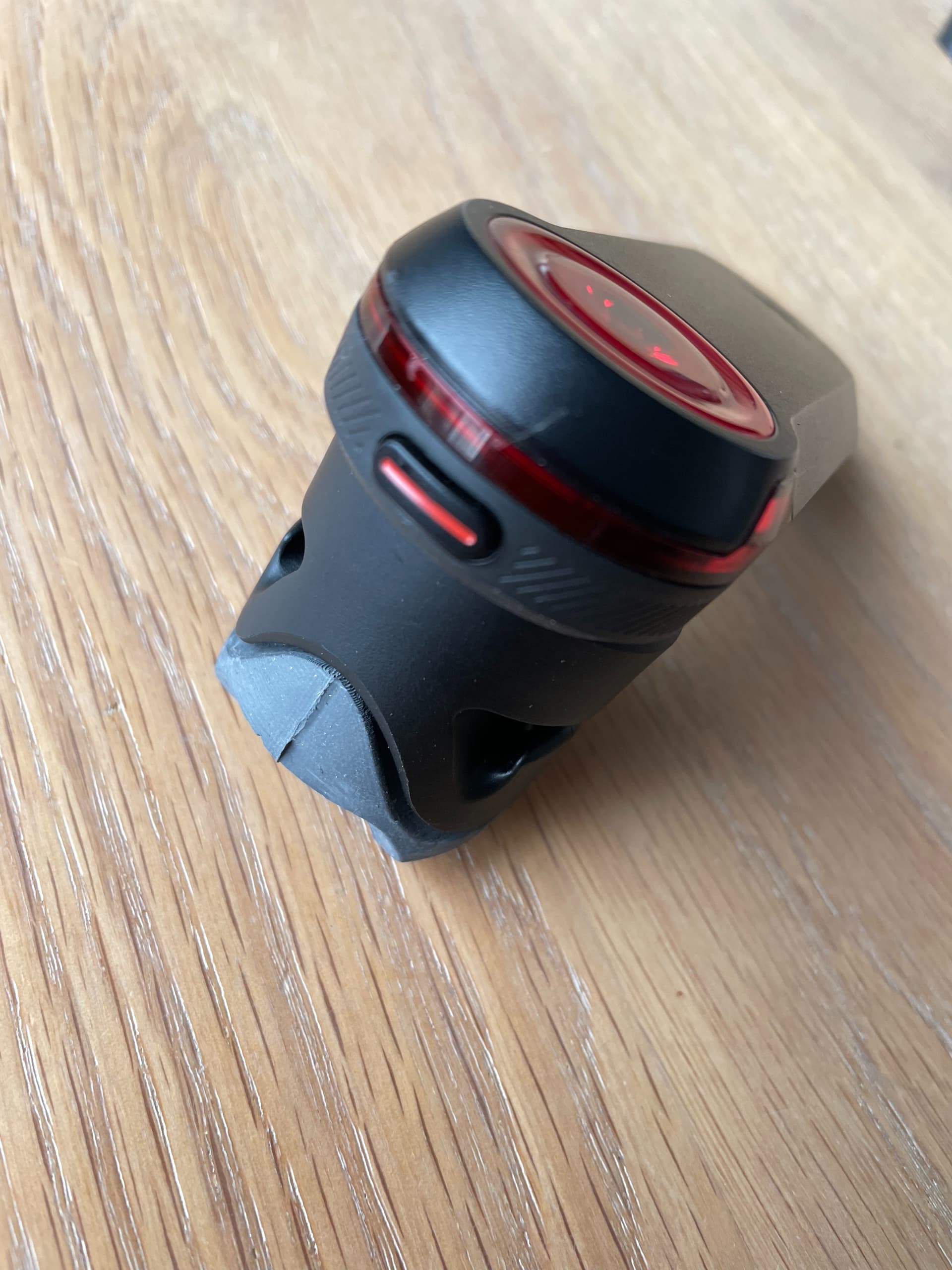

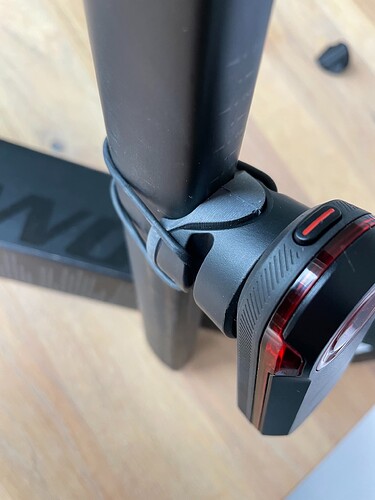

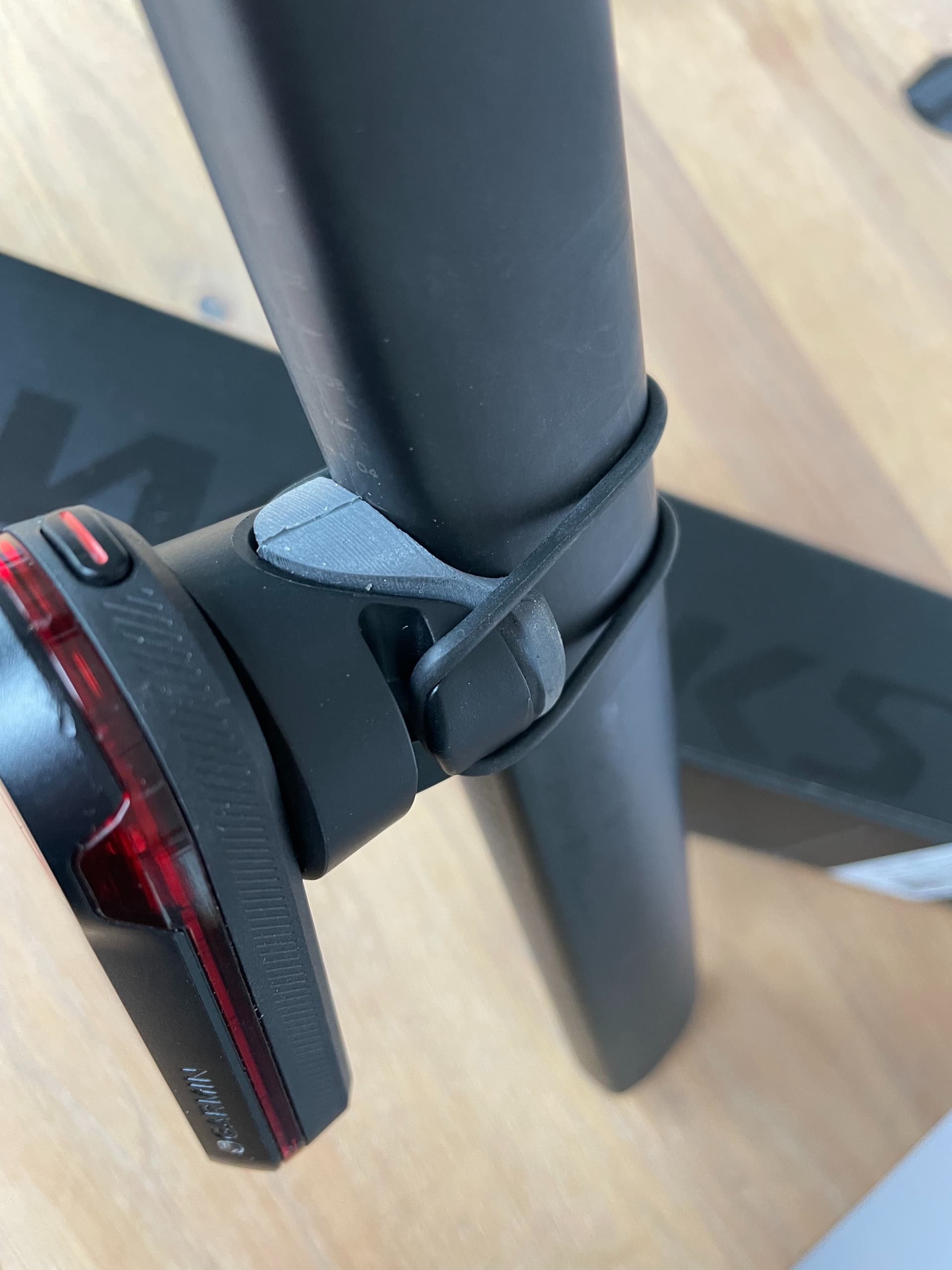

I also had the problem of attaching my Varia well to the seat post of the Tarmac SL7. The supplied adapter does not really fit and so the Varia always twisted while driving. I therefore made my own adapter of industrial silicone. Fits perfectly and uses the original parts.

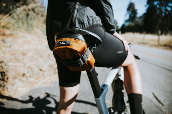

Oh yea, good point! This saddle bag is what I run and it fits behind it nice on my setup and I run my saddle pretty far forward. It slightly curves around the seatpost and then slams against the mount.

Ordered the sugru. Did you guys use the seat post to mold the sugru or did you let it harden and then trim it?
@grayham
I used the post and mount to mould the Sugru. I covered the post in cling film (‘Saran wrap’ in the US I think) and then shoved the Sugru into the mount and then literally mounted the mount over the cling film and wiggled it about a bit, making sure that it was nicely moulded and straight. I then just removed any major excess and left it in place to harden. I didn’t worry too much about the edges, in some ways I think a decent amount of excess is no bad thing because it’s easy to neatly trim with a sharp blade once hardened. Once it’s hardened I just removed it, peeled off the cling film and trimmed it to make it neat. No residue on the post, and nice and smooth all over!

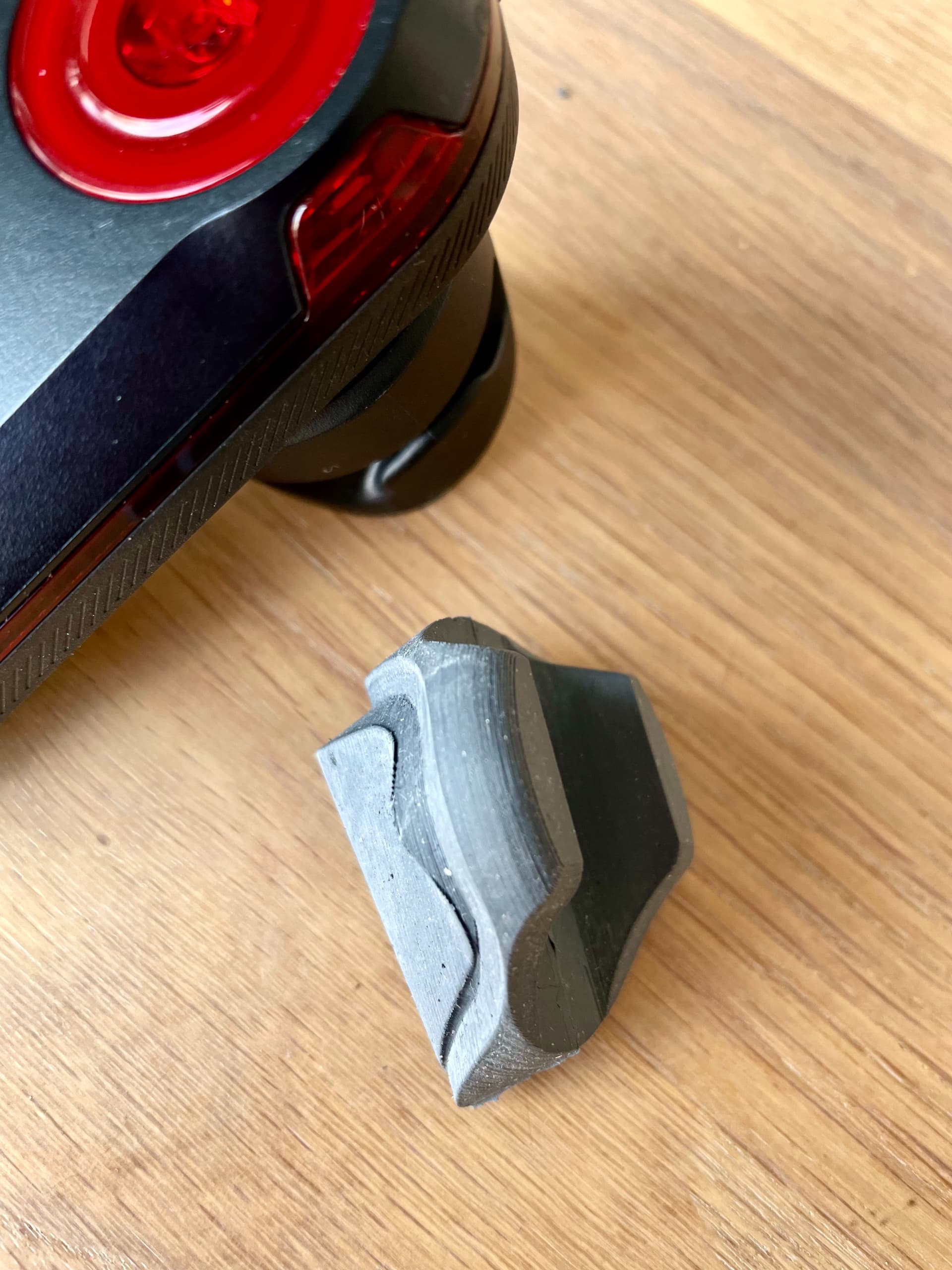

Hi Mazak, can you send me the file 3D printer files for D-Shape? I’ve a Rose bike with this seat post configuration.
BR,
Csaba
I would also really like the file if possible.

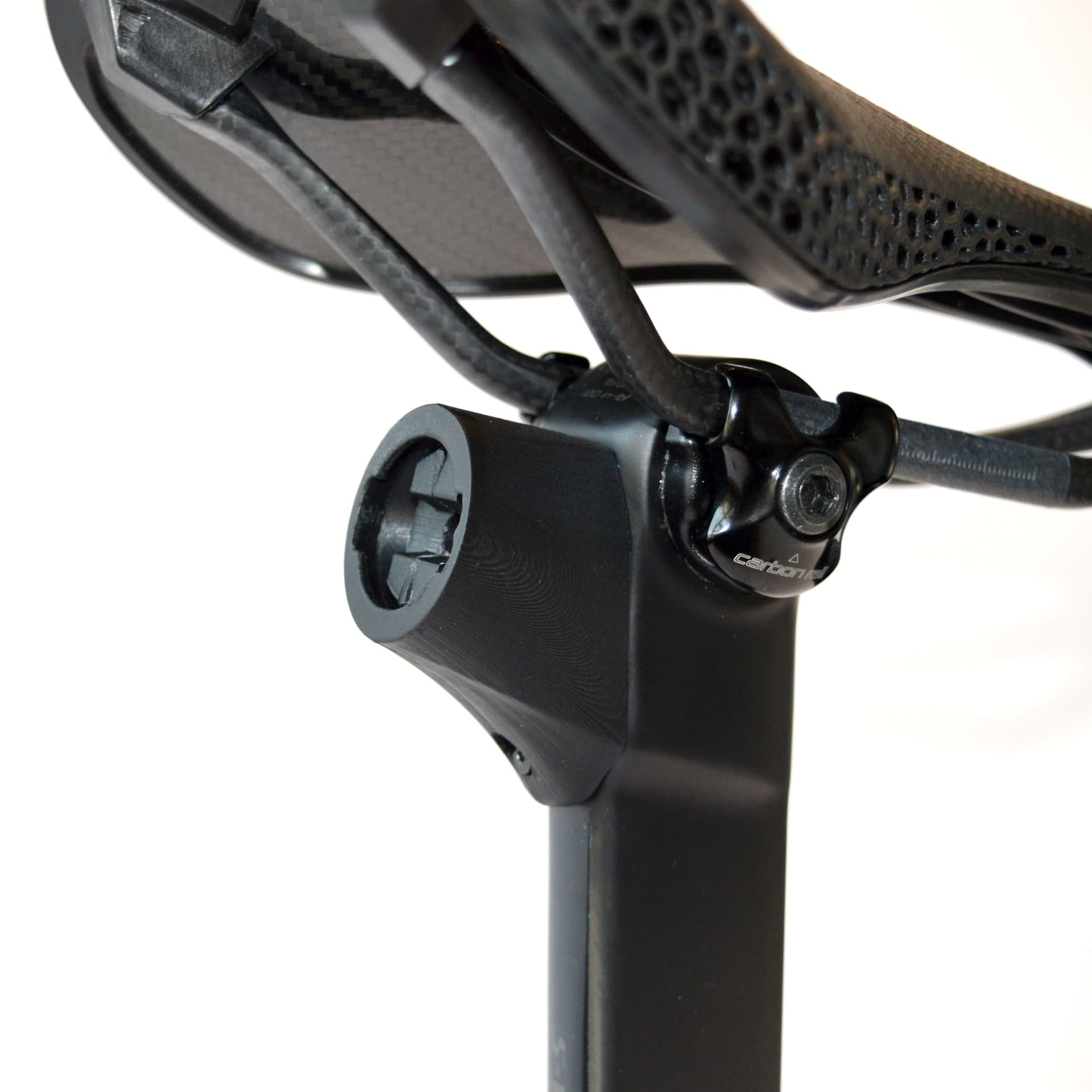

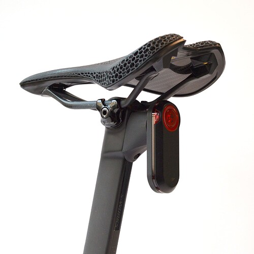

I have now two solutions for Specalized Tarmac SL7. A simple adapter for the original Garmin Solution and a screwed solution for di2 seatposts (with and without backset).
This looks really clean and well done, and I think it would work with my tire kit tucked up there too.
FWIW, I went with @grayham Sugru suggestion and that sucker hasn’t moved at all over the last 1000 miles. It’s rock solid. My only complaint is the height since I have to get it under the Di2 and it’s not as prominent as it was before. That screw in mount might be the solution to that, but for now the Sugru fix is rock solid.
