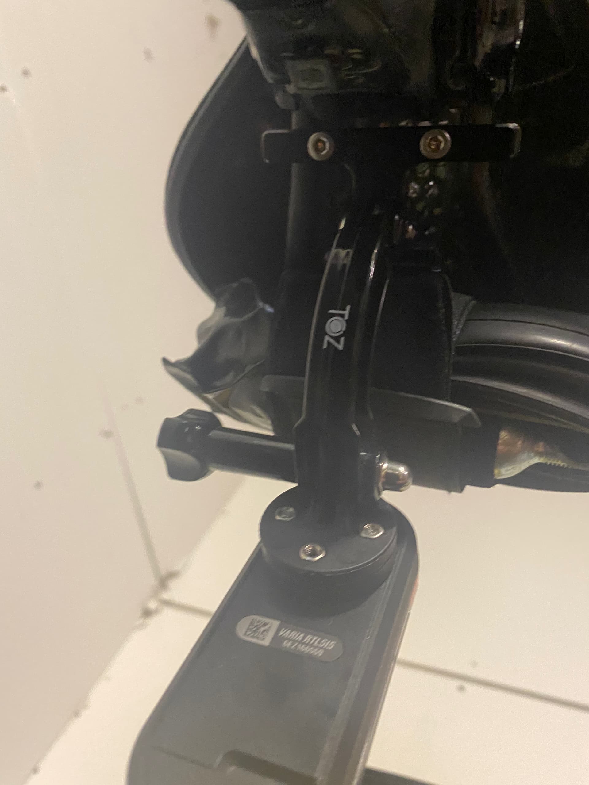

Venge here. My solution was a GoPro mount accessory kit with a curved arm. Think the whole thing was like $12. I like this because it’s rock solid, the radar is perpendicular to the road, and most importantly it’s out and highly visible from under the seat (and my SWAT flat kit).
Surely not very aero though :slight_smile:
Of course not, but I don’t use this except on my training setup where I don’t care anyway.
