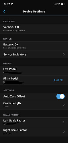

Hi do you do this every ride on same bike or only changing to new bike?
You must have Garmin computer? I have only wahoo. Can this be done another way?
Whenever I reinstall the pedals on any bike.
You might be able to reset angles on your wahoo, garmin connect does not have that option.

When calibrating is it normal a 0.03 or -0.03 will appear for a few seconds? I don’t mean the first number shown. But my number is still moving ever so slightly after zeroing.
