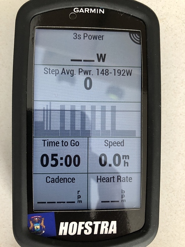

The 510 may be different but on my 1030, there is a field for target power under the workout field section, it does have to be a full width field to see interval target power due to how much text is in the field. This is what it should look like.
Hey Bhofstra,
Thanks for this, but unfortunately the 510 doesnt have such an option.
