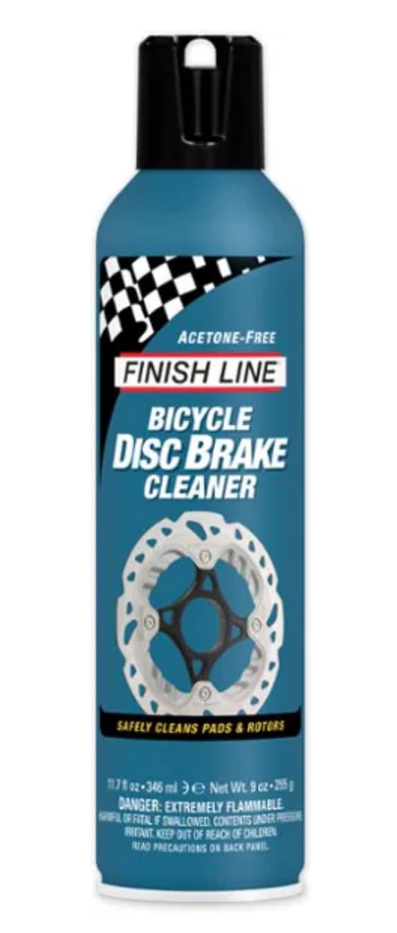

Finish Line disc brake cleaner - worth it?
It’s on sale at REI, and saw it while browsing for any other goodies that were on sale.
Is it on sale because it doesn’t work? Anyone tried it?
Alcohol and Heptane
It’s good stuff if you need to spray. To clean my brake rotors, I just use rubbing alcohol or alcohol wipes.

I’ve tried the pig stuff, and it really didn’t work. I’ve had better luck using a brass drill brush, and iso. But it spreads fine metal particles and probably has a limited life span of working, and will have to swap rotors at some point. (I also got some 240 grit sandpaper for the pads (Be careful you sand them straight)
Some ‘fixes’ last hours, some days of use…
Disc brake cleaner is awesome but just buy the automotive ones off amazon. There are two different types, but i find the flammable ones work best.
$7.49 today
Yeah, I know. Having had so much problems with ‘solutions’, I didn’t know if this was another dud.

I just let my pads keep my rotors clean… and use a damp cloth to wipe the areas the pads don’t contact.

I’ve never had luck with any sort of pad cleaner or squeal-stopper products. I’ve maintained fleets of bikes and have tried everything I could think of to try and decontaminate pads & rotors and haven’t found anything that works.
Sometimes sanding both the pads and rotors and re-bedding them in can work, but not always. Burning is another option, but not one I’m not super fond of.
In my opinion, you don’t want anything on your pads and rotors except for maybe a little isopropyl alcohol if it’s really needed. :man_shrugging:
