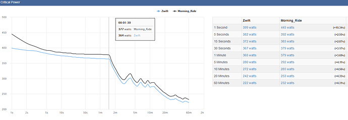

Just following up on my post above. Received my pedals and have now have them set up on the trainer bike (original Tacx Neo) for this week so do some dual recording to check accuracy and setup etc. After a zero-offset, first workout with them this morning and the results were as follows:
Pedals tracking higher than the Neo by a pretty constant % it would seem. Thoughts? Generally as expected?
At the end of the week the pedals will be going on the outdoor bike and I will decide if I will continue to swap them between indoor/ bike and use power match or make an offset on the pedals to align with the Neo and keep them for outdoors only…
Generally as expected. I have a similar % discrepancy between Duo pedals vs Kickr Core (Duo pedals read higher). I suspect it the accuracy difference comes from two sources:
  1. Estimated RPM vs Measured RPM. I think most smart trainers estimate RPM.
  2. Smart trainers obviously measure power at a different point in the system and I’m not sure how (or if?) they account for drivetrain loses?

Is that analysis from DCRainmaker’s tool or something else?
I’ve been dual recording Assioma’s with Neo OG this week and they are very close in average (1-3 watts), but I would like to look a little closer at it
I used Zwift Power analysis tool which is free. Let us know how you get on!

Golden Cheetah works pretty well for me.
Just had a quick look - a handy tool thanks
Came out close enough i wouldn’t worry about it again. Assioma’s less than 1% higher ave power over Neo OG., but higher than that in CP short timeframes
Cadence is a bit higher, which fits as i always feel my cadence is slightly higher on the Neo than it reads.
