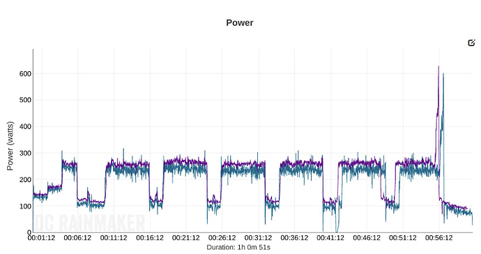

Is anyone aware of an easy and FREE way to compare data files (overlap them). DC Rainmaker’s is $5 for a one time go. i.e. I run the pedals with my head unit to get a .fit file and run the trainer into trainerroad?
If you’ve done this already with the aforementioned pieces of gear, what were you results like?
I basically did exactly this to compare my dumb trainer’s virtual power to my duos. I ran a workout with my head unit (bolt) capturing actual power and TR capturing virtual using the speed sensor. Uploading both to the DCR Analyzer let me see that there was about an 8.5% inflation to my virtual power. One thing to watch out for is that I stopped pedaling at one point to pick up a dropped towel and my head unit auto-paused which kind of threw the two files off by a bit, however I was able to export the combined file and correct it.
Golden Cheetah has a compare screen.
Zwift Power has a file compare that works quite well and is free. I’ve been using it a lot recently chasing Powermatch issues and it has been really helpful.
I’ve used the DCR Analyzer a fair amount over the last couple of years. Maybe not enough to justify the subscription that I pay, but I figure it’s a good way to support him / the site, which I read avidly. The Analyzer tool is very good, mainly because it’s so easy to use.
