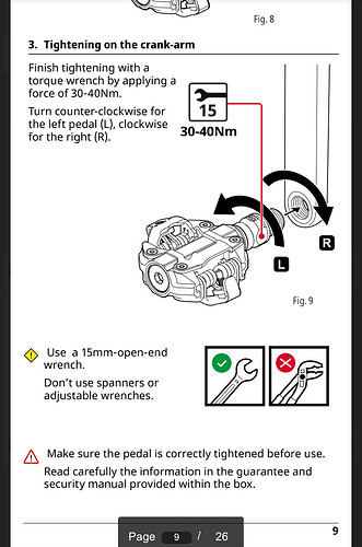

It looks as though they recommend the same torque specs for installation as garmin.
https://drive.google.com/drive/mobile/folders/1CFWAFoJdtvmE62PBU39utc52udQzc7KZ
