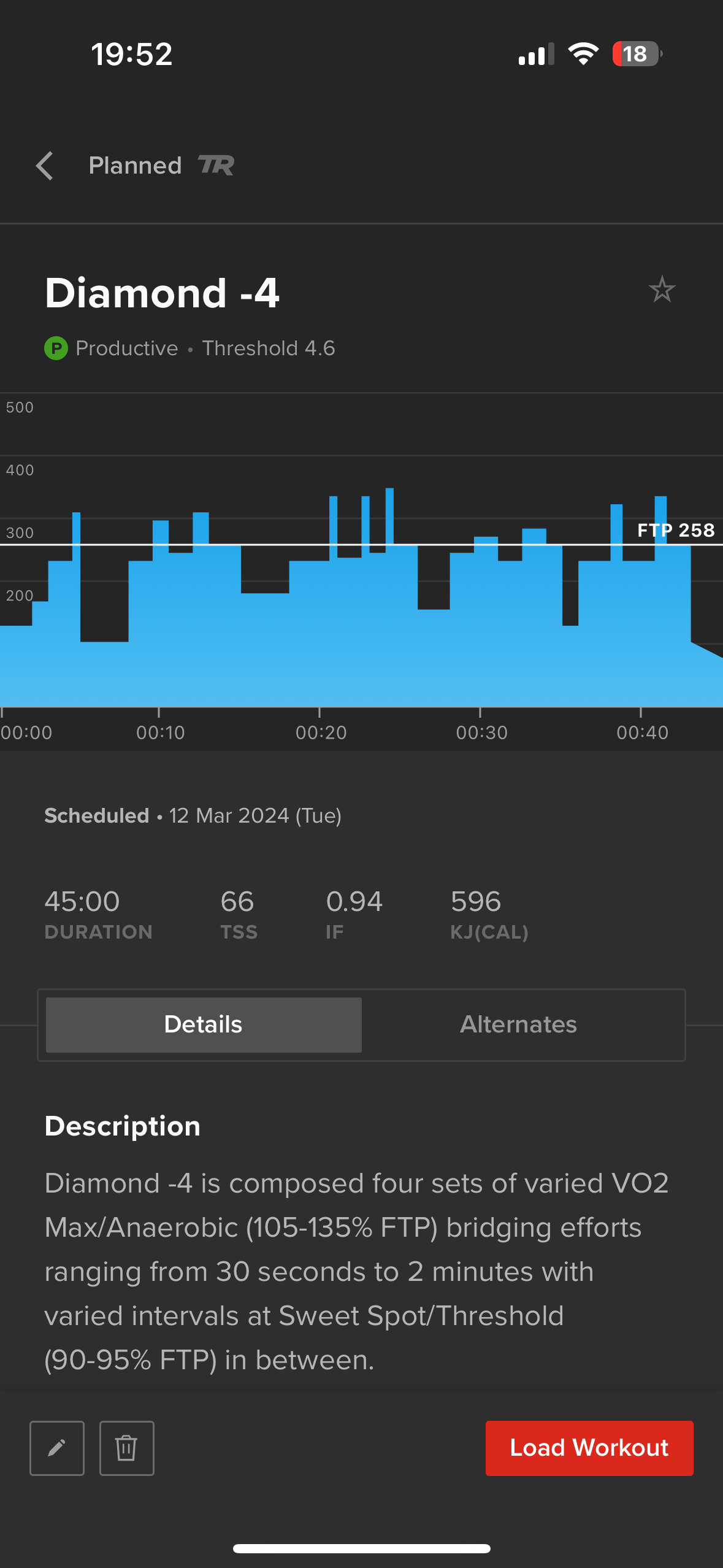

Now I have this. I think I’m going to look through alternates for simple flat workouts.
That one actually looks doable, less time above threshold and it’s only 45min total.
Well spotted! Didn’t even notice the duration. Just so used to all my Threshold workouts being 90 mins.
Maybe I’ll give it a go. Week after is similar but an hour.
