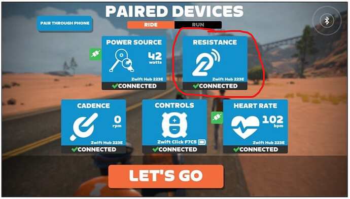

In Zwift - hit “A” - unselect “controllable”. Really as simple as that…
That is true for PC & Mac (A as the device menu shortcut).
  • The common item regardless of where someone runs Zwift is the “Paired Devices” screen and it’s now called “Resistance” instead of Controllable.
I’m aware of this setting. But for some reason, regardless of the combination of connections, TR and Zwift still seem to fight over the connection and it goes into what amounts to Resistance mode. Maybe I just need to replace my ANT+ dongles or something if no one else has trouble with this?
It’s also beside the point - I’m really looking for simplicity, and firing up a single application, clicking on a workout, and getting started is a lot easier than juggling two apps, even when everything is working smoothly.
It can definitely be flaky at times. Although I have never paired my Zwift PC to my wife’s Neo, it will pop into the Resistance box at random startups about 3-6 times per month. So I know for a fact that connections via Z can sometimes spring in there unwanted and unnoticed since it can rip through that pairing screen on startup at times.
Ha! Except that the button you need to click on is now labelled “Resistance”, not “Controllable” :smile:

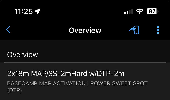

just looked at my 840, and FWIW, yesterday I did a workout with very unique name and it is not in my Workouts. I did change the name in Garmin Connect after the ride.
The workout came from TrainingPeaks.
Some of last week’s TP workouts are in my 840’s Workout folder, and some are not.
Not sure what’s going on, but I’m not complaining or praising how it’s handled. My daily workouts are always on the 840, except in some circumstances when I’m in the garage making last minute changes (adding cadence ranges and possibly changing names). That usually works, but sometimes I open GC and force the workout to sync. Doesn’t happen often but it does happen from time to time.
:man_shrugging:
p.s. on the 840 workout menu I swipped left on a workout and a trash can icon appeared, tapped it and the workout was deleted from my device. Just like a smart phone.

Meh - it is still the same button in the same place…
I would like to be able to use the TR app as a recorder only in some cases (Zwift races basically) - and there seems to be no way to make the TR app do record only, it always has some control of the trainer even if you put it into Free Ride workout as you have to choose between Erg, Resistance and Standard mode, there’s no equivalent of that button in Zwift. I thought leaving it in Erg mode might work as there’s no power target in Free Ride, but then it tries to switch itself to Resistance mode I think and fights against Zwift.
You can do this on one laptop - if you have an ANT dongle. You need one of the apps to connect through ANT and the other to connect through Bluetooth.
