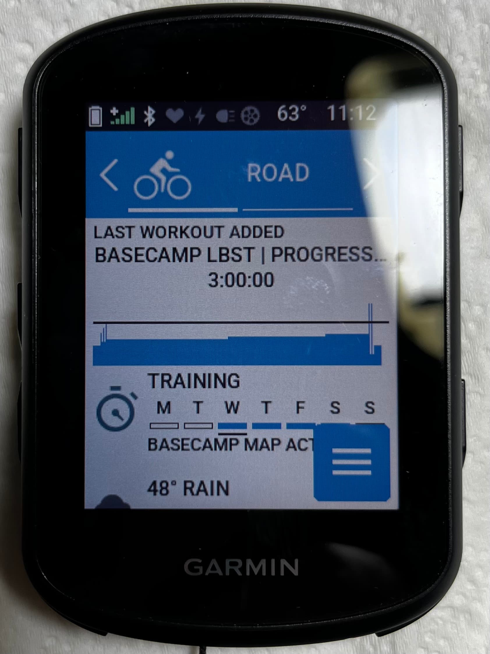

Example from 840:
Last added workout is BaseCamp LBST … which is coming up in 11 days. Todays workout can be seen below in the TRAINING widget, BaseCamp MAP ACT…
I’ll end up renaming those workouts to something easier to identify when the 840 is in my hand or on the bike.

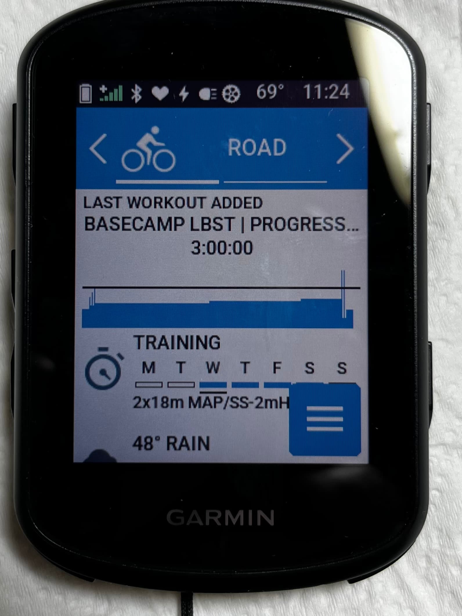

So my Garmin 840 is turned on for those screenshots. Right now I went into TP, added cadence ranges, and renamed to something sensible for myself. Looking down at 840 its already synced:
however it only shows under TRAINING widget. I consider that a bug. Whatever, every electronic device I own has some quirks or bugs.

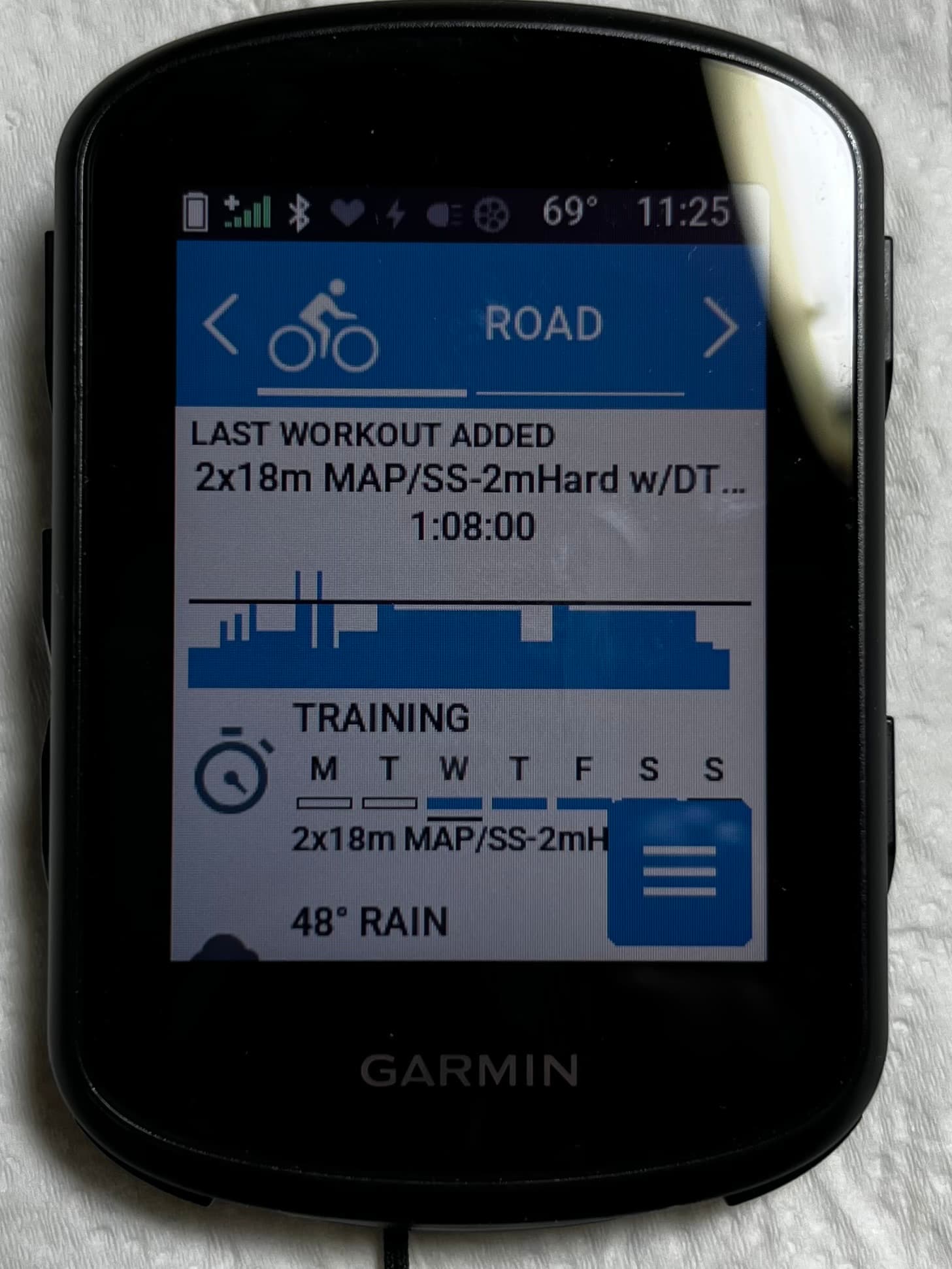

Opened Garmin Connect on my iPhone, tapped the workout, and clicked on the sync icon on the top:
then back out to main screen and see its already syncing to 840.
Now it shows as both last workout added, and todays workout:

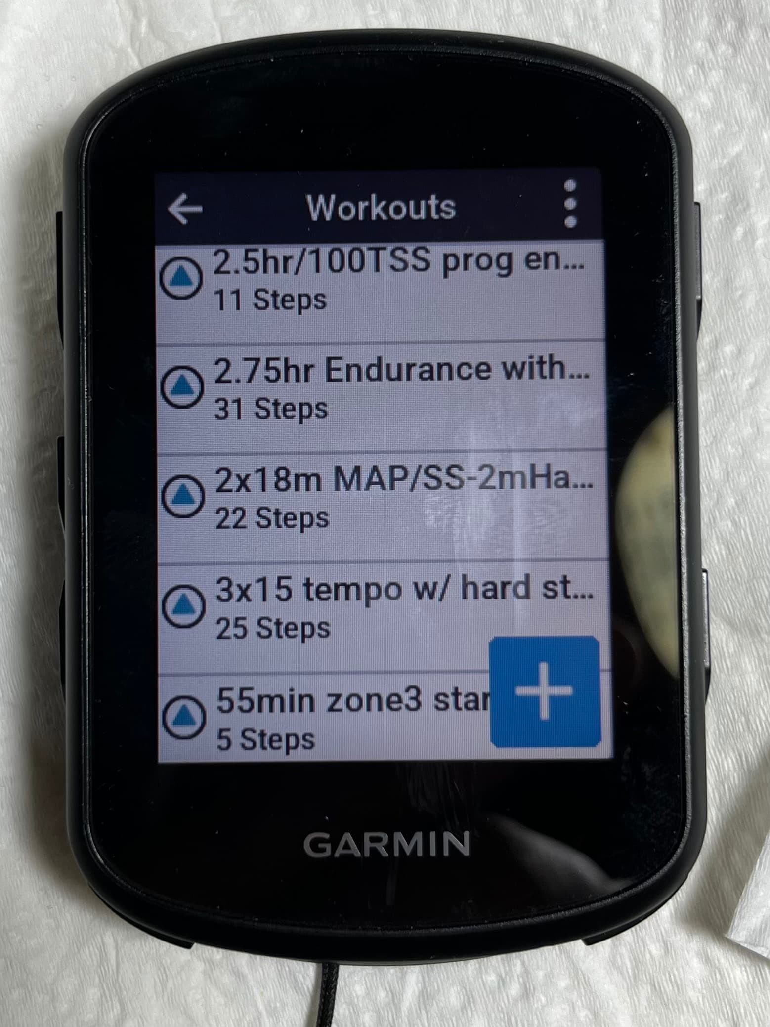

Here is current list on device:

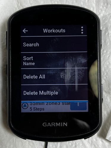

Ok, about viewing and deleting workouts.
Click the three vertical dots in upper right corner.
You can do the following:
  • search
  • change sort by Name (default), newest first, oldest first
  • delete all
  • delete multiple
So on my 840 its possible to have the workouts sorted by newest first, if thats your preference.
You can easily delete everything, or only delete workouts you select.
