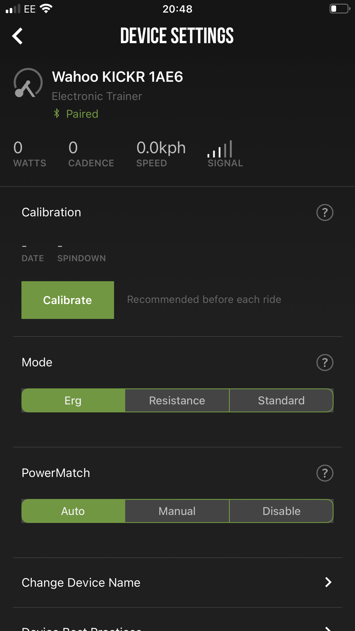

Thanks so much for the prompt reply. Here’s a screenshot suggesting that Erg mode is selected…image
Yeah, at a quick glance, that seems correct. I suspect you will need TR support to dig into the related workout logs or other tools they have on hand. Sorry I don’t have more to offer.
