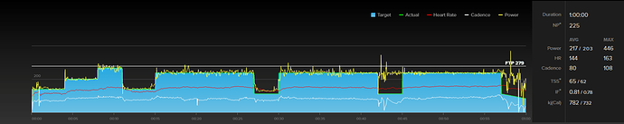

How’s this?
@Vincent313 I had what may be a similar problem a few days ago. The workout was White+2 but I don’t think the workout was the problem. Erg mode set the first power but would not change it after that. If I manually adjusted power up the trainer would respond at first but then return right back to the first warm up power interval. Tried a different workout, same result.
I ended up killing the TR software with extreme prejudice, re-launching, allowing software updates, and then all was well with the world. Haven’t had any issues since. I’m running from a windows 10 laptop.
Probably a similar type of error, but not the same as I only encounter problems when really going massively down in Watts. Good to know that your problem was resolved!
Today is a rest day but tomorrow I’ll first do a calibration from the Tacx app before training. All my iPhone software (e.g. the iOS and the TR app) are up-to-date.
By the way as you can see in my screenshot I tried to play with cadence, but no luck.
Looks like a disconnect during the 2nd interval. I’ve had that a few times. It’s like the trainer does not receive commands from TR anymore, but still broadcasts (I assume power is coming from the trainer, maybe cadence too). My generic solution to those have been to disconnect power to the trainer, count to 5, and reconnect. This is a very scientific solution, of course.
