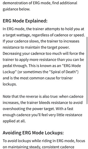

I donāt think this is right. Do you mean torque? Power stays the same regardless of cadence in Erg mode.
