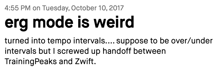

:+1: I’ve been saying that since day 1 and have posted this several times:
That first impression never changed over 2 years of using erg, and I kept drinking the kool aid by telling myself a few different stories. Starting with Wahoo’s “ultimate way to train - with power!” claim.
