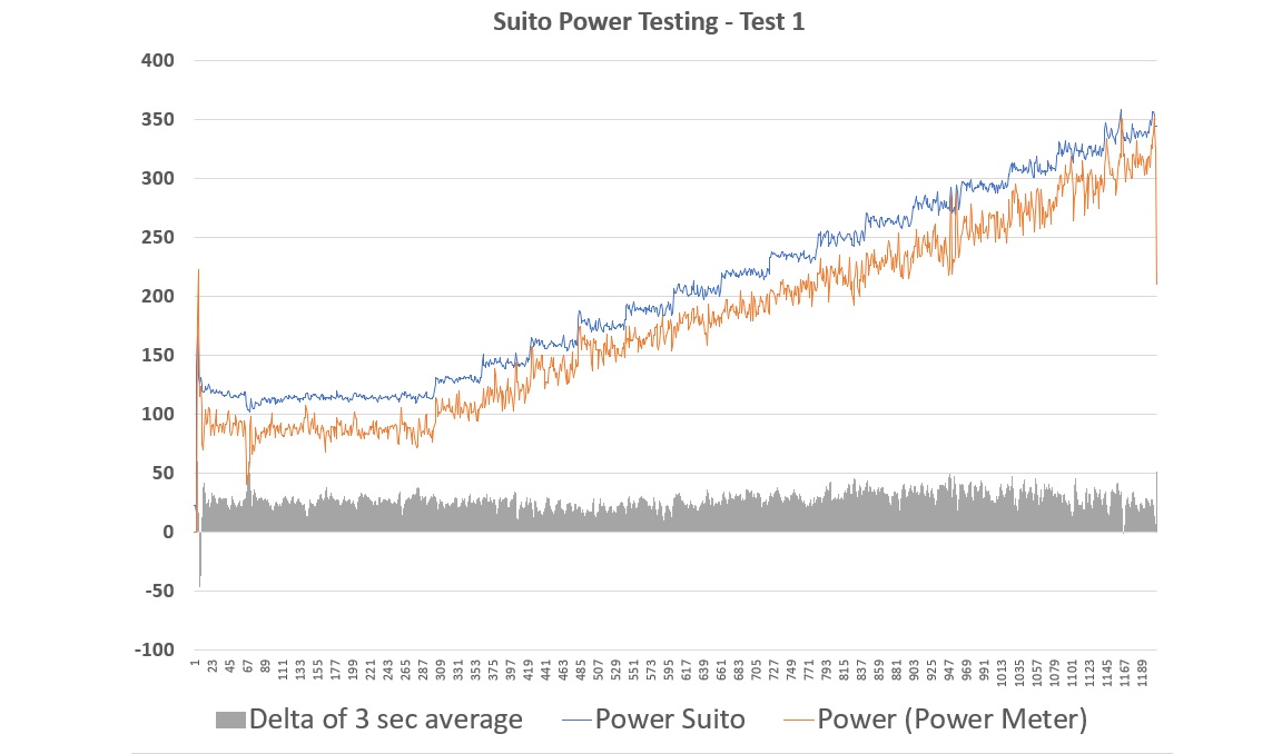

Received my Suito. So far dissapointed as trainer seems 20-30watts reading too high even after calibration. Submitted a ticket, hopefully its sorted soon.

I have done a few more rides. Overall, first impressions of the trainer are pretty good with the exception of the power. Obviously though that is its primary purpose and so it is a major issue to resolve and my recommendation to anybody would be to wait to see that these power issues that are being reported are resolved before choosing this as a trainer. I honestly don’t think it is acceptable that a company advertises 2.5% accuracy but it appears to be more than 10% out.
See snapshots of power accuracy issues.
This was tested with a stages power meter. Now i know that left/right imbalance not ideal for testing purposes, but
  • I have a powertap power meter that i have previously compared the Stages too, and get similar power numbers
  • I did another test (not shown here) with single leg pedal at 100w, and if i halved the Stages power meter result i still land up 20-30 watts short of what the Suito is reading consistent with these tests, and
  • I also have a number of years of power meter riding so have a reasonable “feel”.
In short, i am pretty sure the Suito is not producing accurate power numbers, particularly because there are other similar reports of inaccurate power emerging.
These are all after following the calibration procedure of the trainer.
Edit - i have submitted a ticket with Elite, but they are busy analysing after i sent them the test results. Will post whether it gets resolved at some point.

I don’t consider a manufacturer telling users to use power meter matching a viable or acceptable option, be it Elite, Tacx, or Inside Ride.
I discussed this with Elite today a bit, and there are two concurrent issues for Suito:
A) Power accuracy (in a variety of scenarios): They’re saying 2-3 weeks out to fix this.
B) Flywheel vibration for some users: They’re working with manufacturing to narrow down this issue and why certain units are beyond spec.
Ultimately, at this point I wouldn’t recommend buying one until they work out these kinks. If they can (and I can verify that), then I’d happily change my mind. You’ll note my post has had a banner since yesterday or the day before basically stating that. :frowning:
